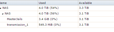

The fact that you are listing directories with backslashes makes me suspicious that you are getting these numbers from Windows. Is that correct? If so, I would discount what you are seeing. ZFS does some weird things with space, and I've definitely seen some odd inconsistencies between Windows explorer readings via SMB and the actual used space. To get an accurate reading of how much space is being used, you'll want to refer to the FreeNAS GUI or via the command line.

After checking in the GUI.. I am using 4TB of my 8TB HDD. and I remove all my data on it.
Reason for cleaning it.. I am selling the HDD and building a better FreeNAS rig.

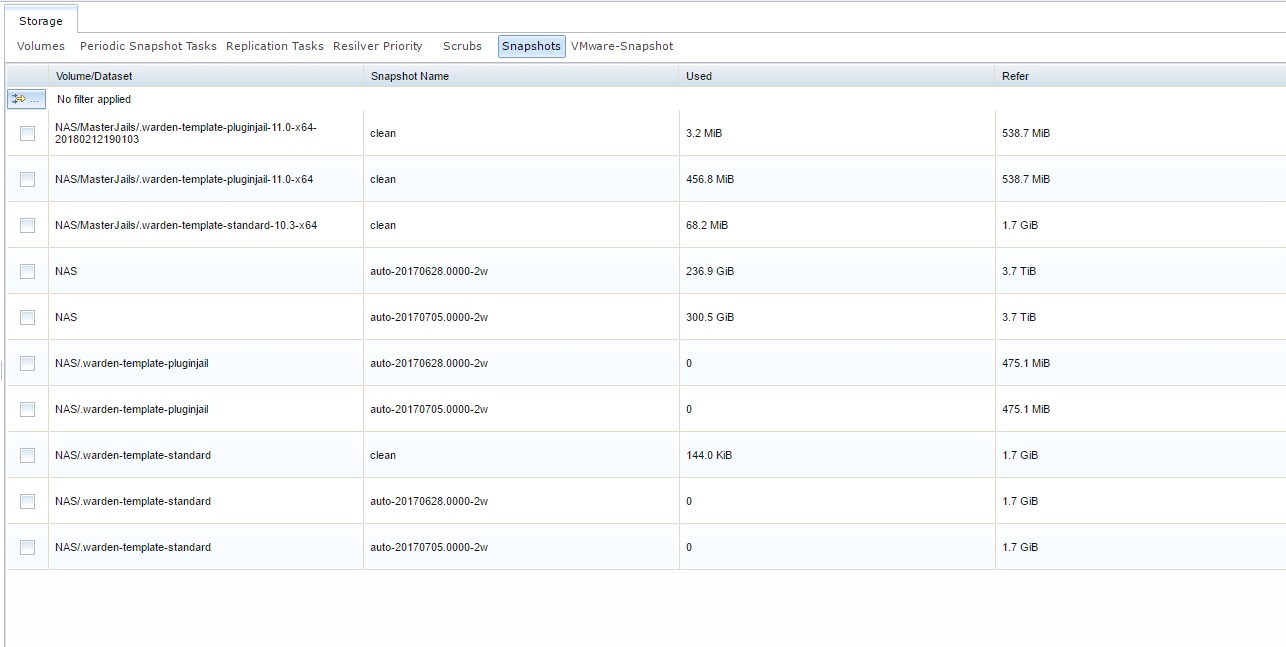

If you have snapshots set up then until you delete those snapshots, you will still use that space. Check if you have snapshots.

Nick2253
Apr 21, 2014
1,633
So basically the snapshot are stored in the jails when you set that up.
Also is the data is kinda compressed?
Snapshots and jails are different things, and I think you're getting them mixed up here. Snapshots are a fundamental part of each dataset. From your screenshot, the big snapshots that are taking up a bunch of space are the two "auto" snapshots of the NAS dataset. The fact that they only use about 500GB makes me think that you still have data on your NAS dataset, because if everything was deleted, then the used amount would be the same as the refer amount.

Yes I removed all of my data. But still about 3.4 TB was used and I didnt know why. With the help here I found out that the Snapshot where using that much space. (*Shown in the Screenshot, previous reply*)

Ok. As previously mentioned, it is likely due to existing snapshots that you haven't deleted. If you have a already saved the data or you don't care about the data that you said you already deleted, then just delete all the snapshots and you will reclaim that space.
Or, as others have suggested, the easier way is to just wipe the drives with any wiping program. That will also delete the snapshots.
