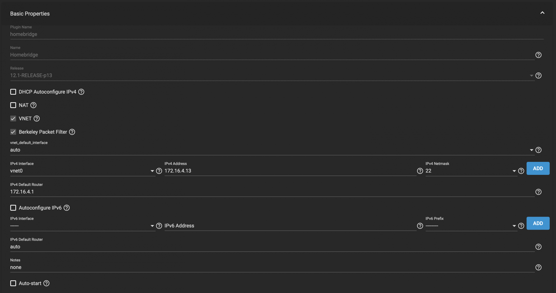

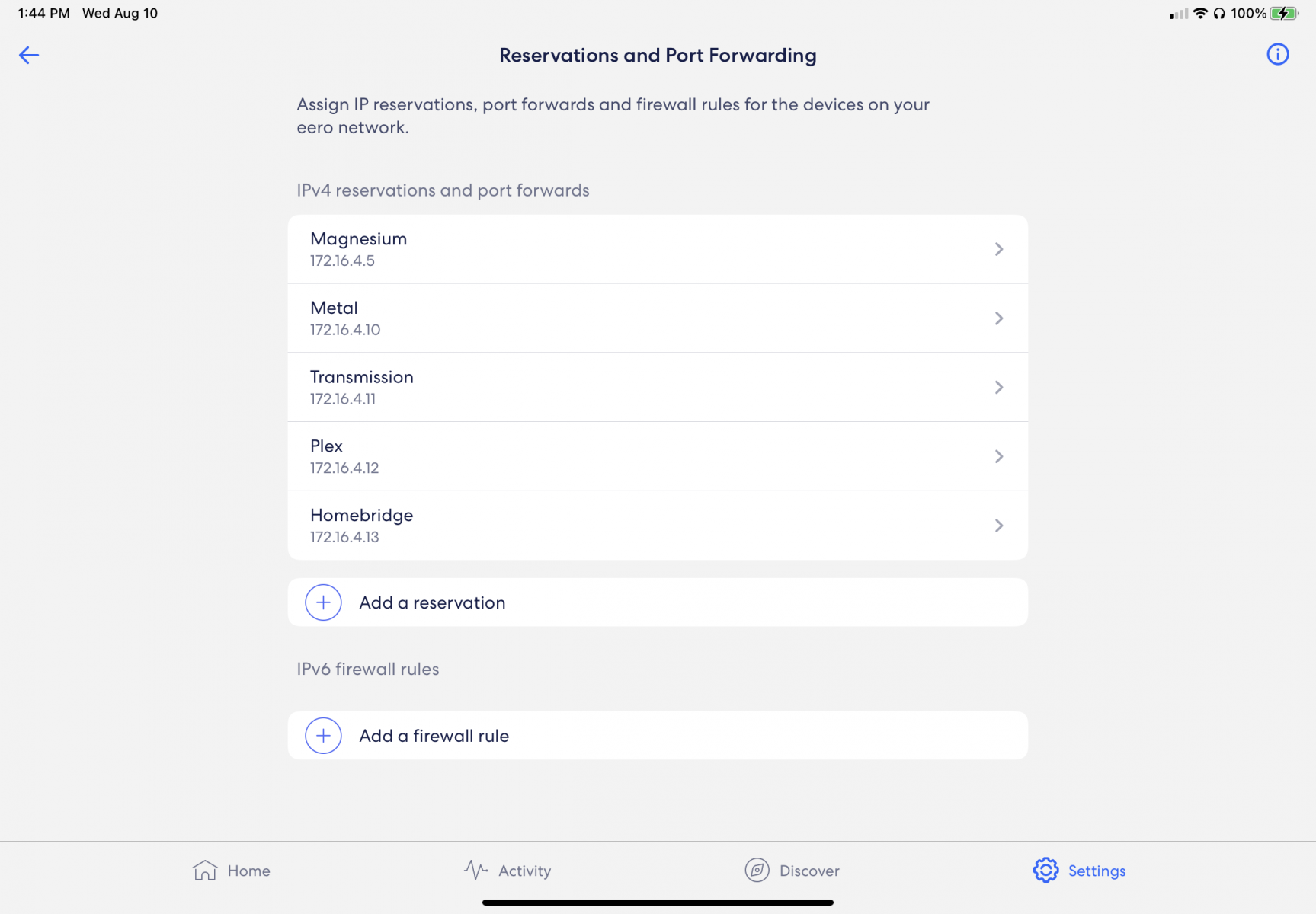

I have a FreeNAS server with several jails connected to my Eero gateway (mesh wifi setup). The jails are on the same subnet as the rest of LAN.
The problem is that the jails are only accessible from devices directly connected to the gateway (Ethernet or WiFi). Whenever I try to access these from another eero around the house (I have in 3 total - 1 gateway, 2 leafs), those jails (and only those jails - rest of LAN is OK) are not accessible.
