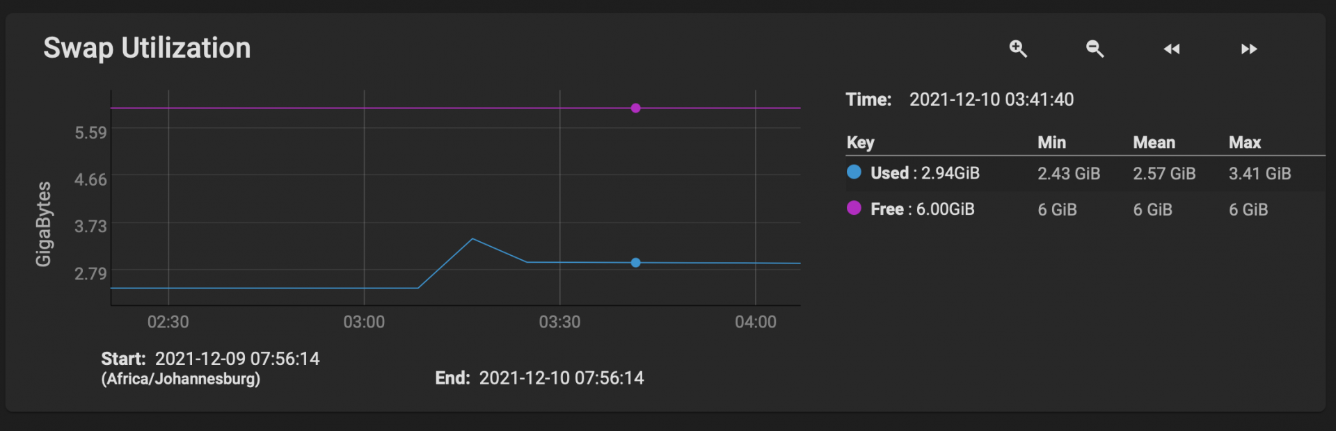

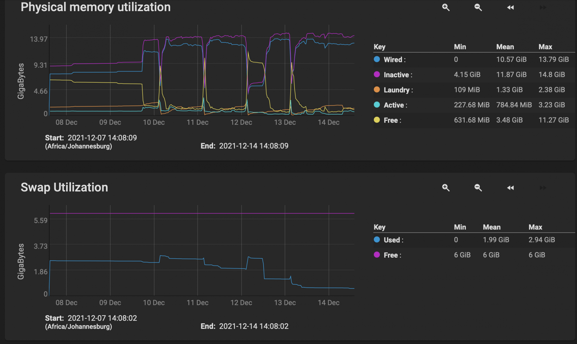

my posting of the diagram was a "question", we're saying I'm running out of swop, but if we look at those graphs no sign of that

The graphs only have 5 minute resolution (which is the default for RRD). Your console log is definitive. In fact, your swap graph is already very bad; normal behavior is to have 0 swap utilization, with very, very infrequent swap usage. In your case, you're using swap constantly.
Since Plex dies, you should look at your Plex overnight maintenance activities.

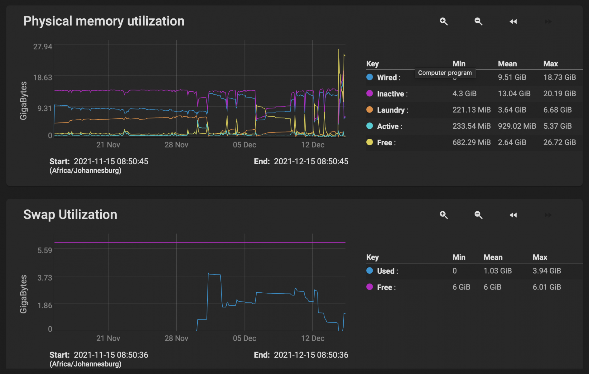

... as said... the wheels started coking off at the last update, see attached.
let me see if there is a "new'er" version of Plex also.

something is def errant, if you look at that 4 week swap space usage... don't think this is just me using swop, because not enough RAM, something fundamentally change a couple of weeks ago, which is the root cause. I got double the RAM now and still...
anyone that know how to deep diagnose this, would be appreciated,
for as like all support systems first question is mos always, are you running the most recent stable... well I'm busy running update as we speak.
I did Plex yesterday, which it seems did not help by itself as it died last night again,
did notice yesterday in some log (can't remember what where)...but seems something happened at at 03:30, need to see if I can scale back in logs, and see if this is repeated daily...

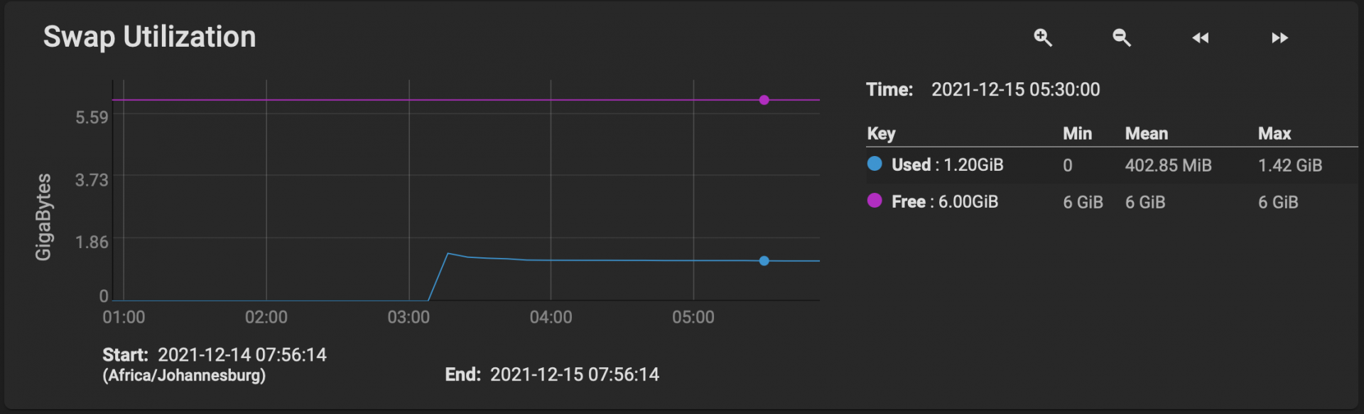

Correction, it seems to be daily at approx 03:03... see 2 diagrams attached.
But this does not look like a big enough bump in swap to cause the problem...
can swap be increased ?

Right, but that chart has 5 minute granularity, so there may be spikes... But I'm still kind of hung up on the "why", and it has me wondering if there's something in the jail config. I tried "iocage get memoryuse plex" and found mine had a value of "off". I'm wondering if yours has some limit set somewhere. Can you run "iocage get all plex" and post the result here? This is assuming you jail is named "plex".
