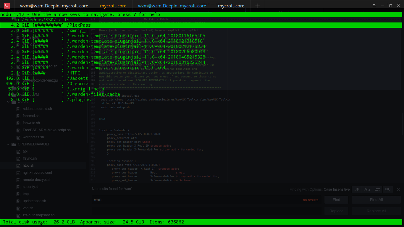

Hey guys, just a quick question here.
I have a jail HTPC ( see screen DeepinScreenshot_20180520081846.png) that takes up nearly 100GiB but when i check all the files of the jail, its only a few GiB ( see other screens ).
I have deleted all of the SSD volume snapshots so it cant be the space those take up.
Please advise.
DeepinScreenshot_20180520081846.png As you see here HTPC takes up quite a bit of space
DeepinScreenshot_20180520082523.png This one is take from withing the iocage jail console, /mnt containts mounted media from the host system.
DeepinScreenshot_20180520082959.png This screen is taken from within the /mnt/SSD/iocage/jails folder, the one that says its 96 GiB (note that i have an sshfs mounted the HDD + SSD on my workstation)

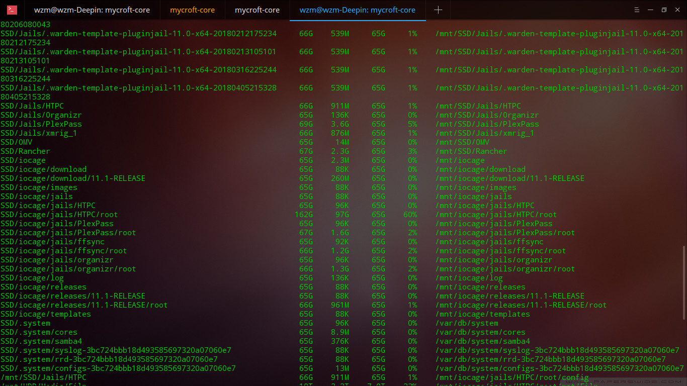

df -h shows some mount points
freenas-boot/ROOT/11.1-U4										 25G	1.8G	 23G	 7%	/

SSD/iocage/jails/HTPC/root									   162G	 97G	 65G	60%	/mnt/iocage/jails/HTPC/root

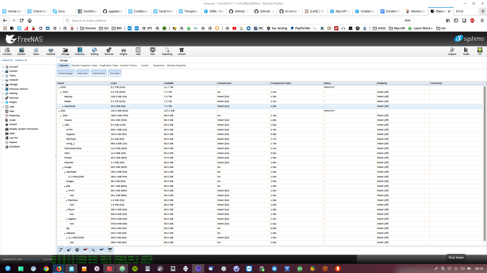

Exactly, if you look at the following screen it shows that besides /mnt (which is mounted from my host with all the media) i only have around 6G worth of space occupied. This screen is using NCDU tool within "iocage console HTPC"
One cause that i would come up with for the content not making up for the supposed 100GB would be a snapshot but those are all gone...
And besides that, why are there 2 locations /mnt/iocage/jails and /mnt/SSD/Jails since they are actually just one origin, right?

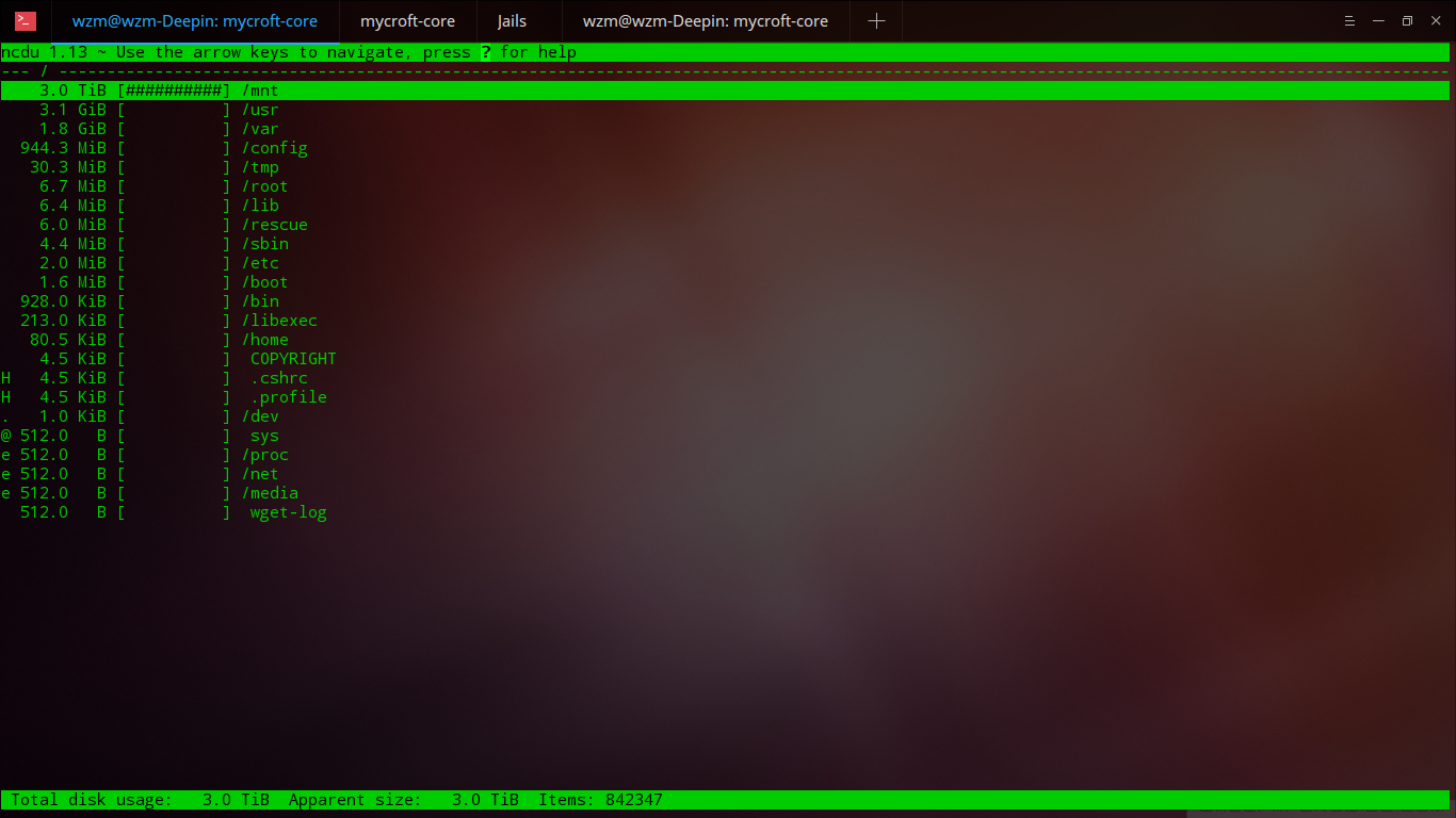

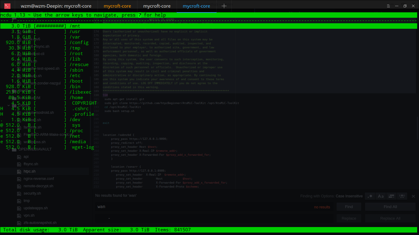

root@HTPC:~ # du -sh *
du: No match.
root@HTPC:~ # du -sh /
3.0T   /
This is because i have a data set mounted that has my media.
This is my / of HTPC jail with NCDU
Verified that there are no snapshots of that size.
Also its not plex since that is another jail.
