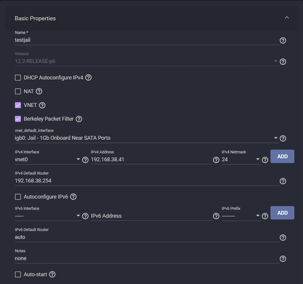

I set up a jail today. Release 12.2-Release-p6
I used VNET, and TrueNAS picked Berkley Packet Filter
I set the networking up as per the screenshot below
I then added allow raw_sockets so I could use ping and traceroute from the jail
When I start this jail - my TrueNAS drops off the network completely and I have to walk to the machine and switch it off. I cannot even ping the IPMI interface - so I am assuming that as the switches seem to go beserk (and are also unreachable) that TrueNAS is blasting crap out onto the network and bringing it down
What I am trying to achieve - and this is what I thought vnet was for is to have an independant IP stack in the jail so I could use different DNS/a different default gateway in the jail
First Question: Have I got the concept correct
Second Question: If "yes" to above any idea what the hell is going wrong?
To clarify I have 5 NICs on the server
  1. 10Gb Main Network, SAMBA Shares
  2. 10Gb Storage Network - different switch, different network. Switch is attached to main network for management purposes
  3. 1Gb Jail Switch on main network
  4. 1Gb Unconnected
  5. IPMI
Oh and I already have a jail on that nic that doesn't use vnet or Berkeley and works - but I cannot change the GW address - it just uses the TrueNAS one.

9,703
What are the IP address details of the host?
NugentS
Apr 16, 2020
2,947
Nic 1: 192.168.38.32 /24
Nic 2: 172.16.16.10 /24
Nic 3: None - I have not assigned an IP in TrueNAS
Nic 4: None
9,703
And which is the one you assigned as the VNET default interface? Nic 3?
NugentS
Apr 16, 2020
2,947
192.168.38.40/24

But I am correct that a vnet is an entirely separate network stack - like a separate PC and thus I can have a vnet on a second interface on the same network as the NAS primary interface.
9,703
NIC 3 - the 1Gb Nic for Jails
OK, so that highlights problem #1 for me... you're trying to have 2 NICs in the same TrueNAS server joined to the same subnet, which is an absolute no according to @jgreco .
NugentS
Apr 16, 2020
2,947
Not sure I am. The Jail has the address - not the TrueNAS box. It 's my understanding that having a jail with a vnet is a valid configuration. TrueNAS has one IP address, the jail has the second
Somewhere I think @jgreco was asked this question and confirmed this was good. Can't find where and of course I am assuming I am doing it the right way.
The concept is that TN does NOT have two NIC's on the network. It actually only has one. TN does not have an IP on the second NIC
That should be fine. Someone else complained that TrueNAS wouldn't create the second network without assigning an IP address to TrueNAS; I don't know if that's true, because I've generally been able to specify "up" in the auxiliary ifconfig parameters and that was fine. If you are really forced to assign an IP, pick an unused RFC1918 network. i.e. if you are using 10.0.0.0/8 addresses, assign em1 as 192.168.2.2/24 or something like that.

I have managed 2 jails on one nic with vnet and no IP on that TN interface.
