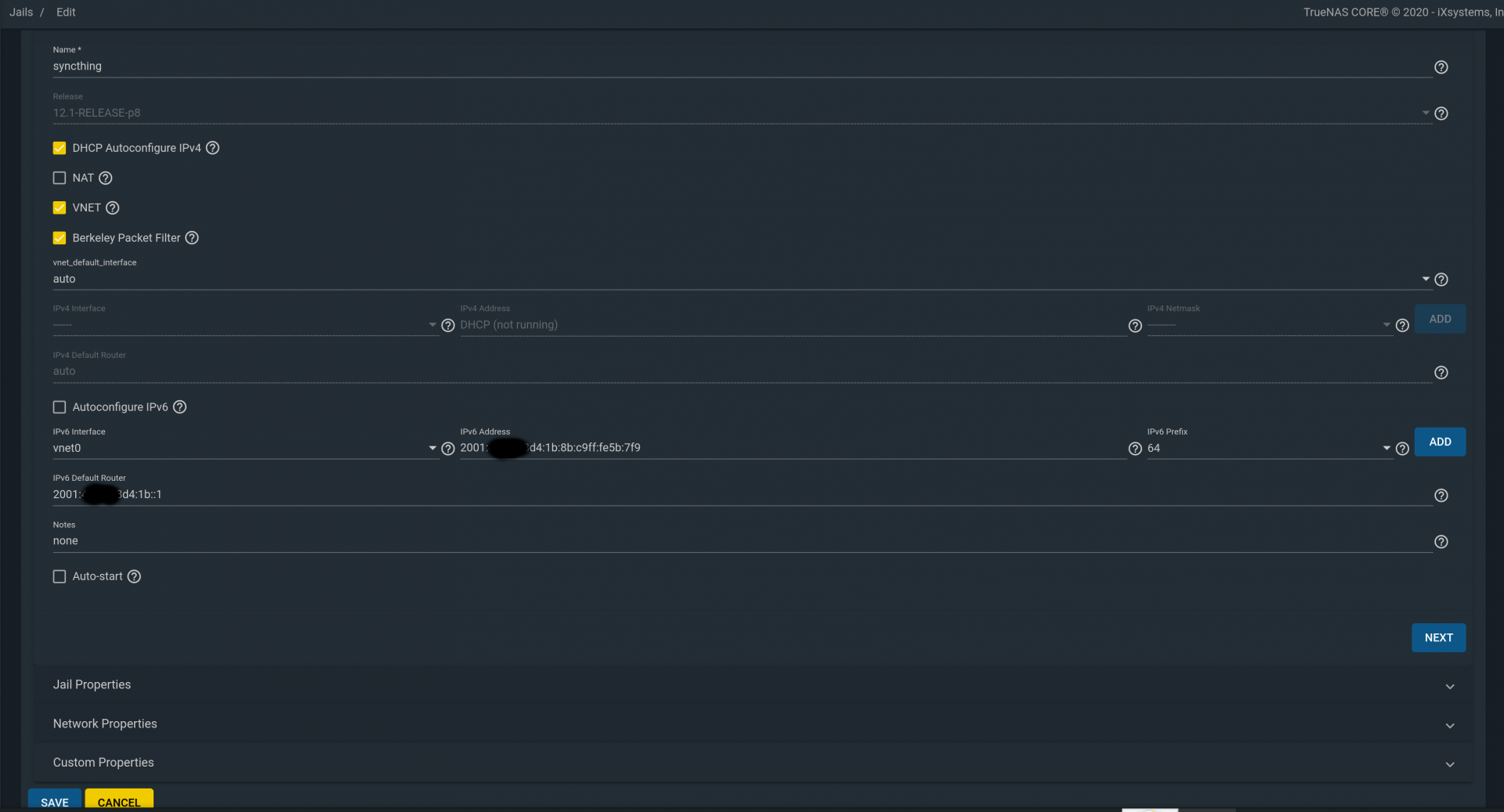

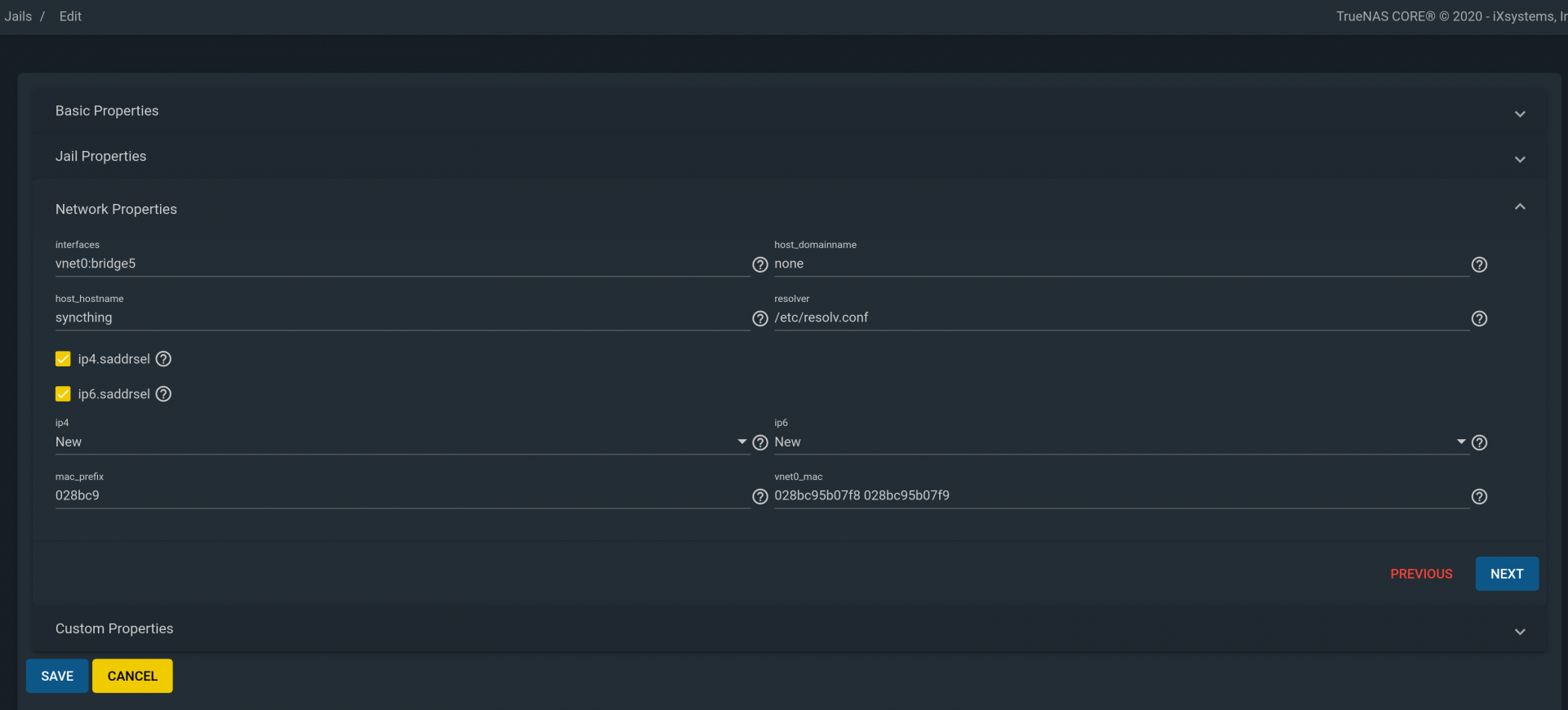

I thought, well ... I have had similar problems like this in the past with IPv6 and jails, let's set the IP address manually as the default gateway, which I did, see screenshots.
Eversince I set it manually jail won't start. When I start it via
iocage start syncthing

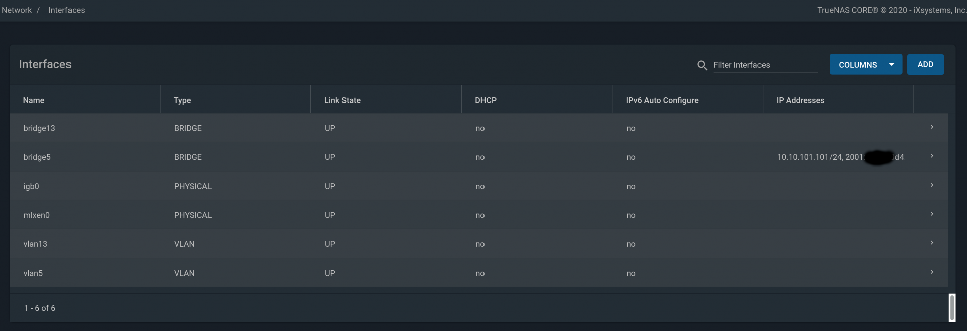

Basis setup of networking is:
Mellanox ConnectX3 10G (mlxen0)
vlan5 interface on top of mlxen0
bridge5 with vlan5 attached to it.
My bhyve guests as well as my jails are connected to bridge 5 (screenshot).

This may not help but it is worth a try. My config is similar to yours except for one thing: I have my IPv4 and IPv6 address on the vlan interface not the bridge interface.

I've deleted all my networking configuration and recreated it from scratch. I also tried to create a completely new jail. The problem still persists.
@Kelly Hays
FreeBSD documentation suggests to always put the IPs on the bridge interface.
