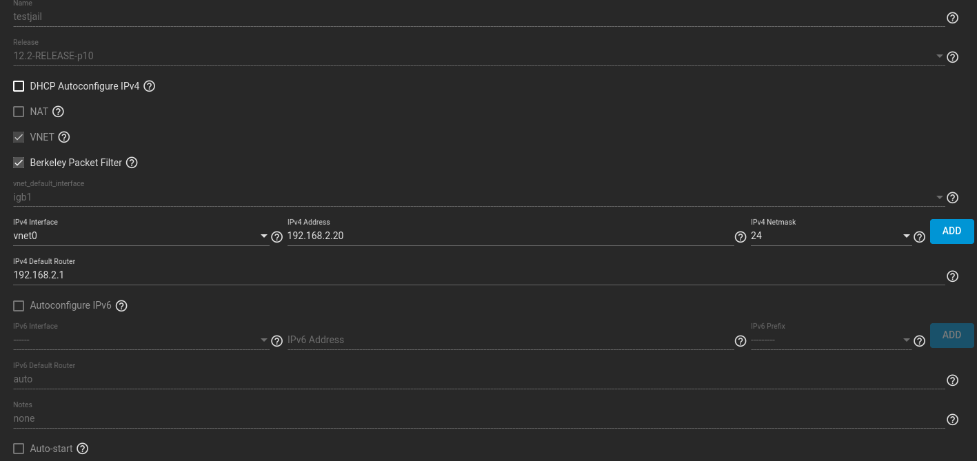

I am running TrueNAS-12.0-U5.1 on a HP Microserver Gen 10 Plus. The device has 4 NICs. The first igb0 is used for the TrueNAS itself. The others should be used for other purposes. So should the igb1 be used for services and jails.
So I installed a jail with the following networksettings. The jail seems to run and networking ist working... But it is terrible slow.
