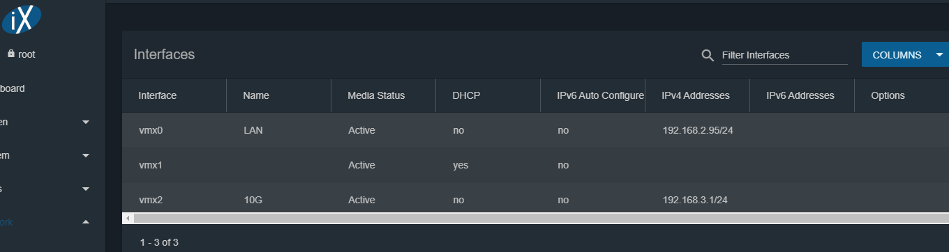

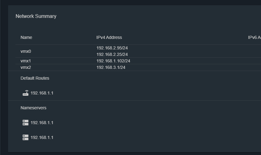

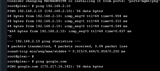

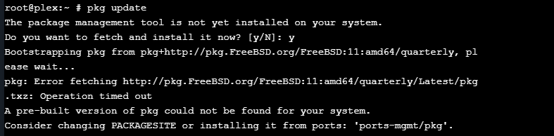

got a similar issue:
FreeNas device.
VMX0 LAN Interface, DHCP by router 192.168.2.10 , /24 subnet
VMX1 DMZ interface, DHCP by 2nd router, 192.168.1.* /24 Subnet with other webservers
VMX2 (10G Point to Point with workstation) -> this one is wayne at this point
I sucessfully configured a nextcloud jail to access VMX1, static IP. Config:

ifconfig in freenas says:
root@freenas[~]# ifconfig
vmx0: flags=8843<UP,BROADCAST,RUNNING,SIMPLEX,MULTICAST> metric 0 mtu 1500
        options=60039b<RXCSUM,TXCSUM,VLAN_MTU,VLAN_HWTAGGING,VLAN_HWCSUM,TSO4,TSO6,RXCSUM_IPV6,TXCSUM_IPV6>
        ether 00:0c:29:44:55:04
        hwaddr 00:0c:29:44:55:04
        inet 192.168.2.95 netmask 0xffffff00 broadcast 192.168.2.255
        inet 192.168.2.25 netmask 0xffffff00 broadcast 192.168.2.255
        media: Ethernet autoselect
        status: active
vmx1: flags=8943<UP,BROADCAST,RUNNING,PROMISC,SIMPLEX,MULTICAST> metric 0 mtu 1500
        ether 00:0c:29:44:55:0e
        hwaddr 00:0c:29:44:55:0e
        inet 192.168.1.102 netmask 0xffffff00 broadcast 192.168.1.255
        inet 192.168.1.200 netmask 0xffffff00 broadcast 192.168.1.255
        status: active

I can ping my router from within the JAIL Plex
I can resolve google.com
But what not works is to do a pkg update
Ideas?

damn, I remember. I had the same issue (no internet) on that VMX1 with DMZ and Nextcloud Jail as well.
I had to set the default gateway for the Freenas Server (in Global Network Config) to 192.168.1.1 - even if i normally wanted it to be the normal LAN Gateway like for every other device in LAN.
That was the only way I could get that seperated subnet to be working with Freenas Jails (by manually entering the DMZ gatewa to Freenas settings). :( Any how I guess I am doing somehing wrong.
It must be possible to have the freenas vmx completely standard in LAN, with IPs listed above and to have the second nic to act for DMZ and several Jails to be connected to it.
Its a buggy mess anyway. If i set my default router ofthe main freenas device testwise to 192.168.2.10, and switch back to 192.168.1.1, the nextcloud jail is unable to be reachable from DMZ machines. So even undoing that default router stuff breaks the jail network.
-> that weird DMZ nameserver + Gateway and default route (other than 192.168.2.10) was experimentally needed to get the nextcloud jail to work fine in the DMZ monthes ago)
It would be nice if someone is able to help me in this. How to get this seperated VLAN internally working. For my nextcloud jail mainly.
That cant be that hard.
