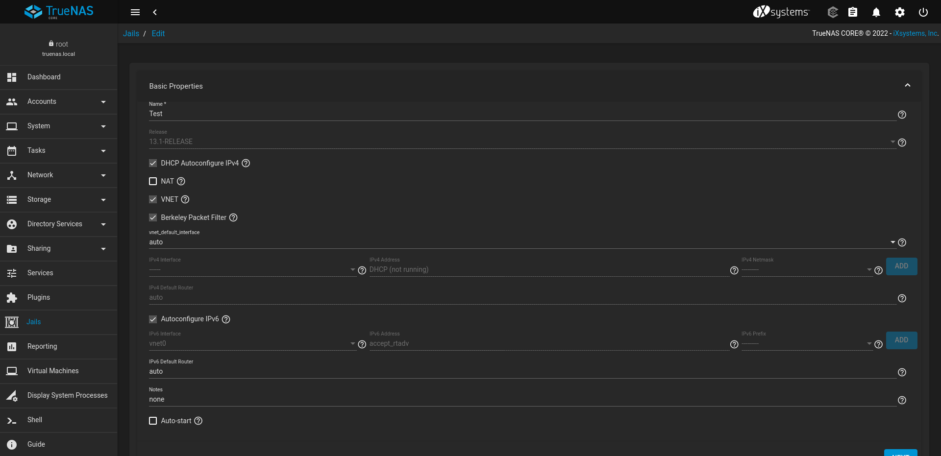

When I try to start my newly created jail I get the following error message:
1663947669862-png.58671
This translates in middlewared.log to :

Ho and the screenshot is from another try, before I started using test as a name for my jail.

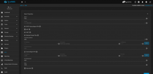

Also noticed that if I got in advanced config bridge0 is selected.
How can I debug this?
