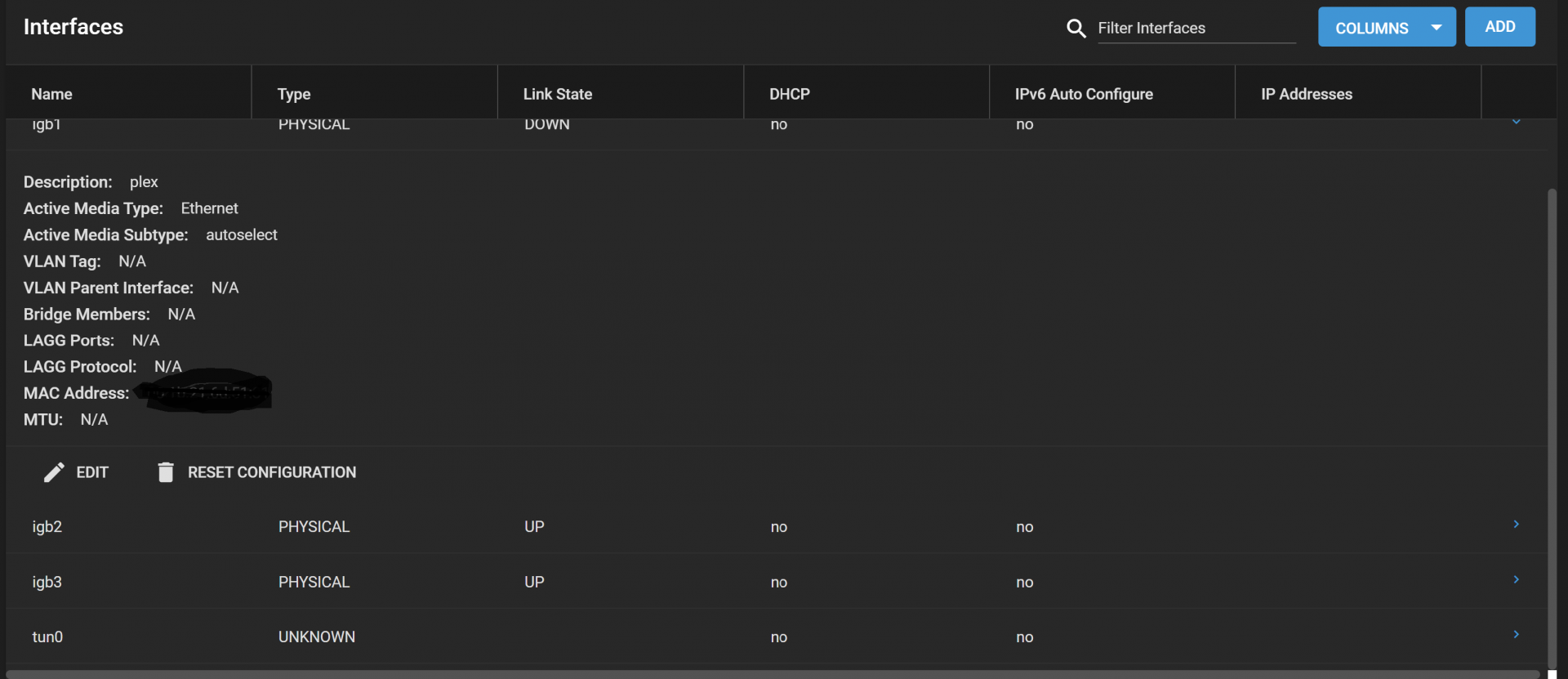

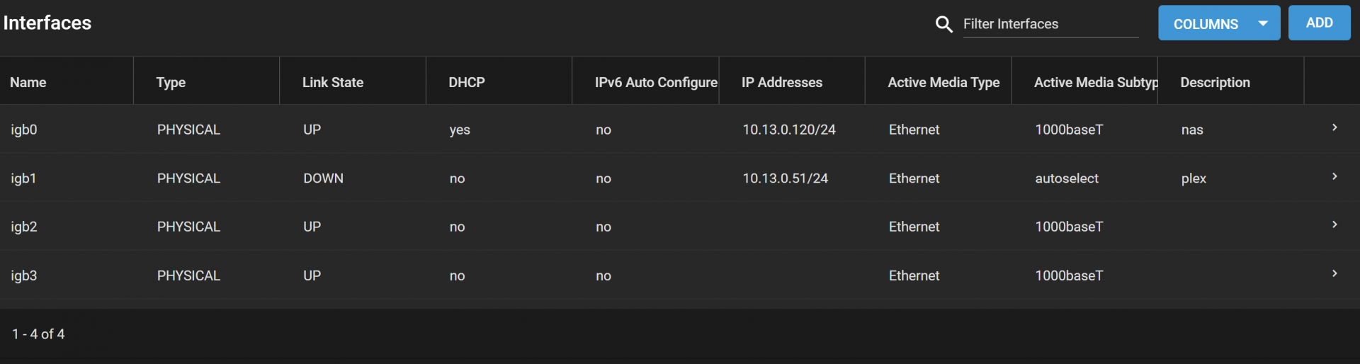

I have a Plex jail that is working fine. It (seems) to be connected to a network interface (igb1:plex) that is marked as down:
I have a 100MB network port on the motherboard that is disabled in BIOS.
I have a 4-port GB network card connected to a switch.
Ports 1 & 2 on the network card are connected to the switch.
When I connect ports 3 &/or 4, my network crashes (still trying to figure that one out - could be a bad card or switch...) so I can only connect the first two ports.
Why/how is Plex connected to igb1:plex when it is marked as down?

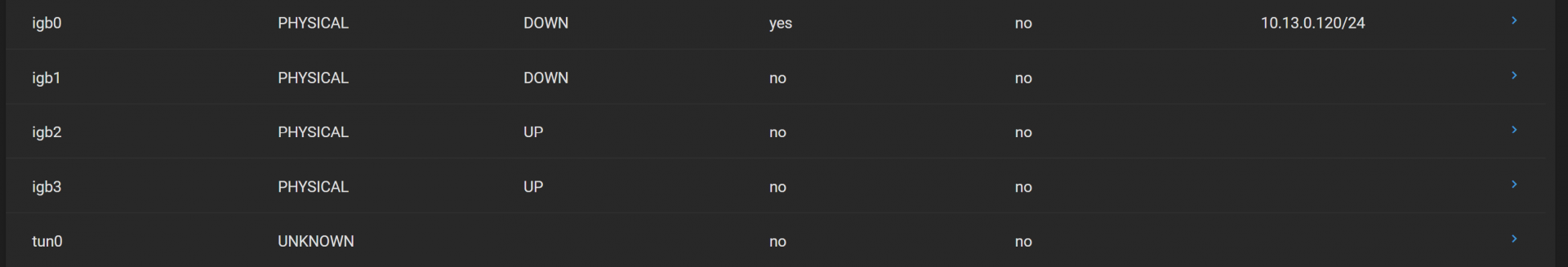

I have torn my nework configuration apart (reset.)
I figured out that the reason the network interfaces were down is because the cables weren't connected (duh). I have now configured igb0 (dhcp) to be dedicated for the host. I am now trying to configure igb1 for the plex and am having issues.

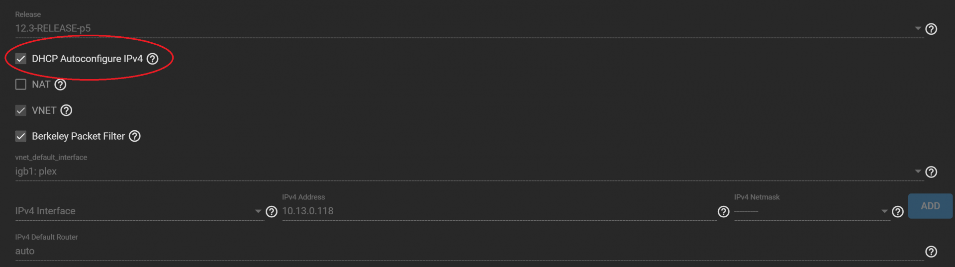

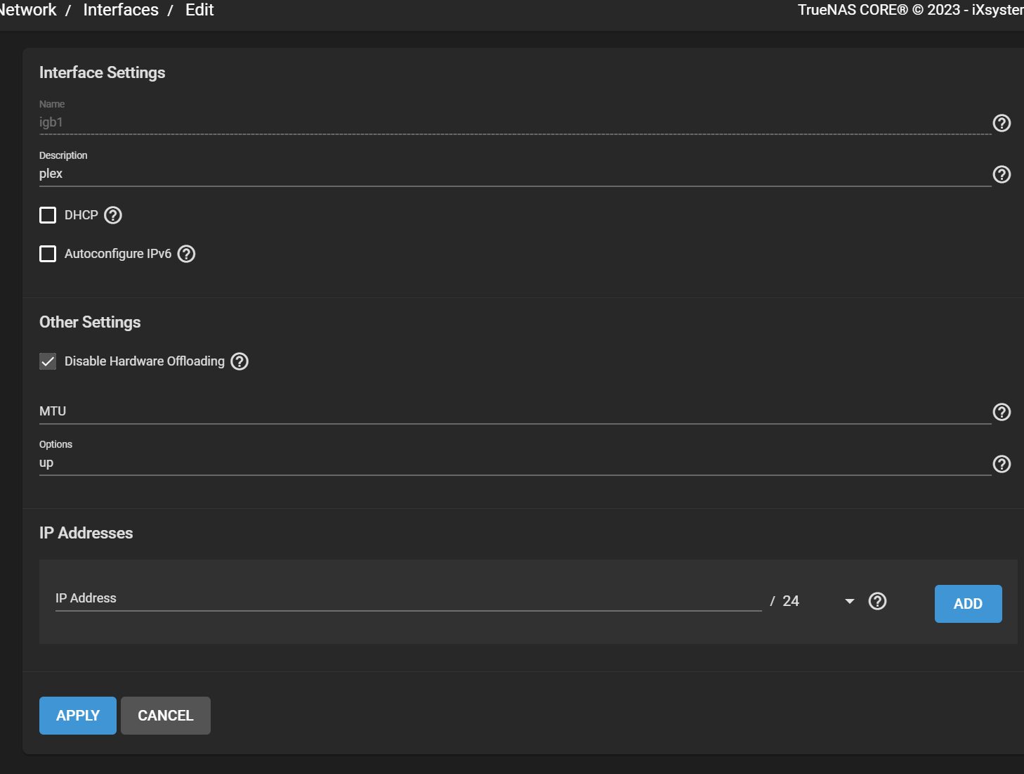

I finally have one dedicated interface working with a single jail. I did this by giving the interface a dedicated ip address:

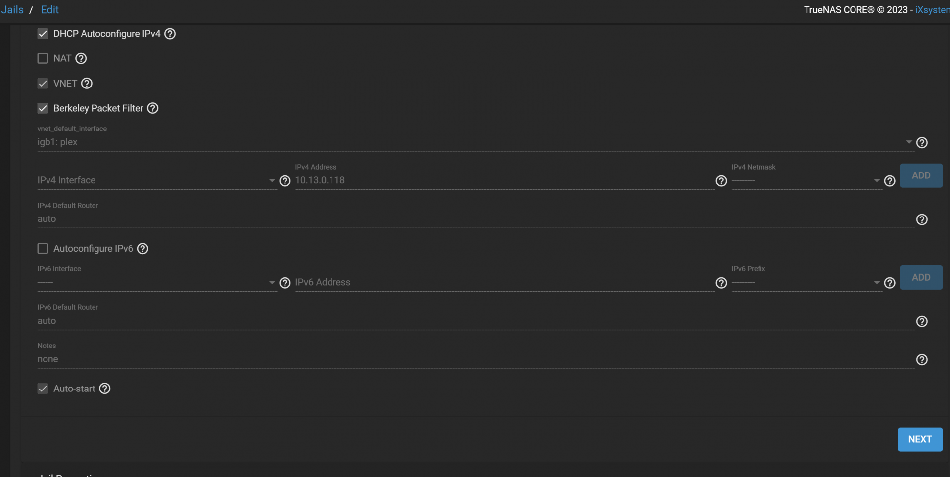

Then, I set the jail to DHCP:
Funny thing is that it somehow got a DHCP address (10.13.0.118) from the router even though it was specified as static:

BTW, this new configuration shows this interface (igb1) as down (even though it is connected and working) and the other two (igb2 and igb3) as up (even though they are not connected to my switch). igb0 is connected to the web interface of truenas (and working fine) so my assumption that "up" means physically connected and "down" means not is incorrect:

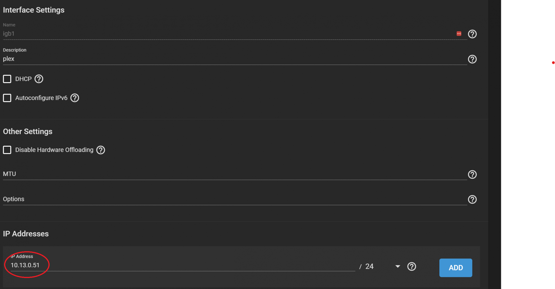

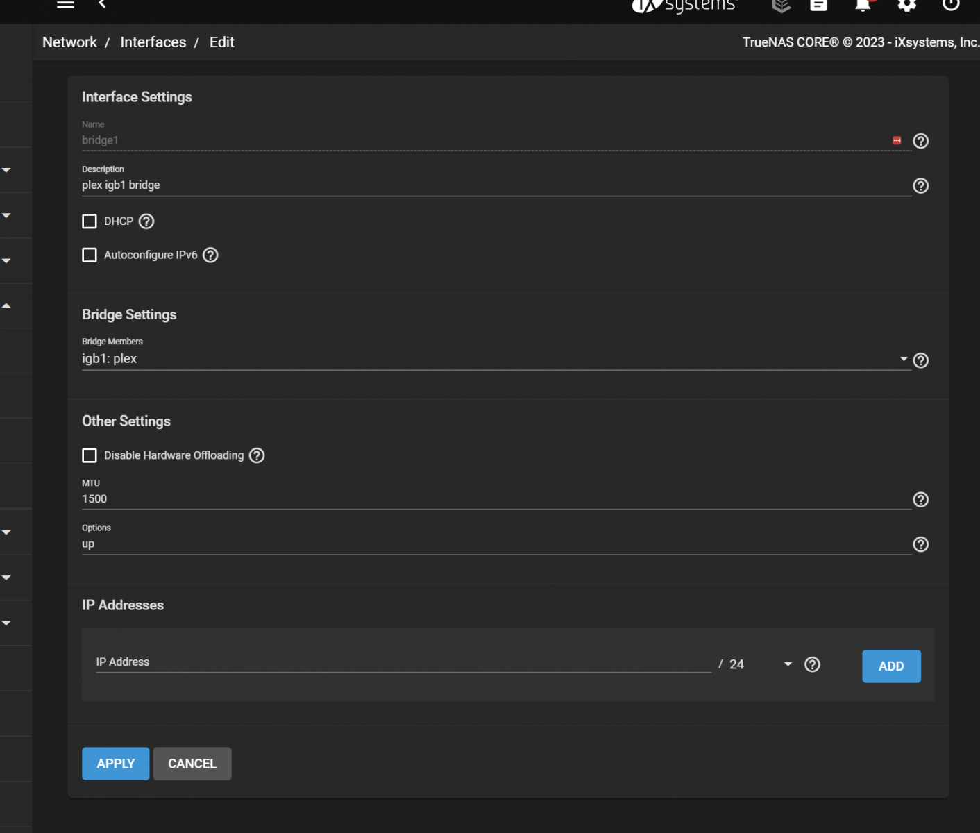

I deleted the settings for igb1 and created a bridge. I had an issue with busy hardware when creating the bridge on igb1 (and can't chase it down right now) so I created bridge2 on igb2 with an address of 10.13.0.51. I shut down all of the vms and jails and assigned all of the jails' to None interface except plex which I left assigned to the default "vnet_default_interface" and started it. Plex got an address of 10.13.0.119 and seems to be running fine.
I am confused that vnet_default_interface is not selectable from the dropdown and how does plex know to use bridge2?

Some progress...
I created the bridge in igb2 with an ip address of 10.13.0.51 (nothing else set)
I set the interface on the jail as follows:
dhcp autoconfigure ipv4: unselected
nat: unselected
vnet: selected
berkeley packet filter: selected
vnet_default_interface: none
ipv4 interface: vnet0 (the only option)
ipv4 address: 10.13.0.52
ipv4 mask: 24
ipv4 default router: 10.13.0.1 (my home router)
this is working for me, but is it correct?

I have removed all previous bridges and created a new one on igb0 (bridge1 as I wasn't sure if bridge0 is valid name):
dhcp: unselected
bridge members igb0
disable hardware offloading: unselected
mtu: 1500
options: blank
ip address: 10.13.0.51
In the jail I get a little lost.
dhcp: unselected
nat: unselected
vnet: selected
BPF: selected (I assume it should be selected)
vnet_default_interface: none (I tried auto and the only other options are igb1, igb2, igb3, bridge1 is missing?)
ipv4 address: 10.13.0.52/24

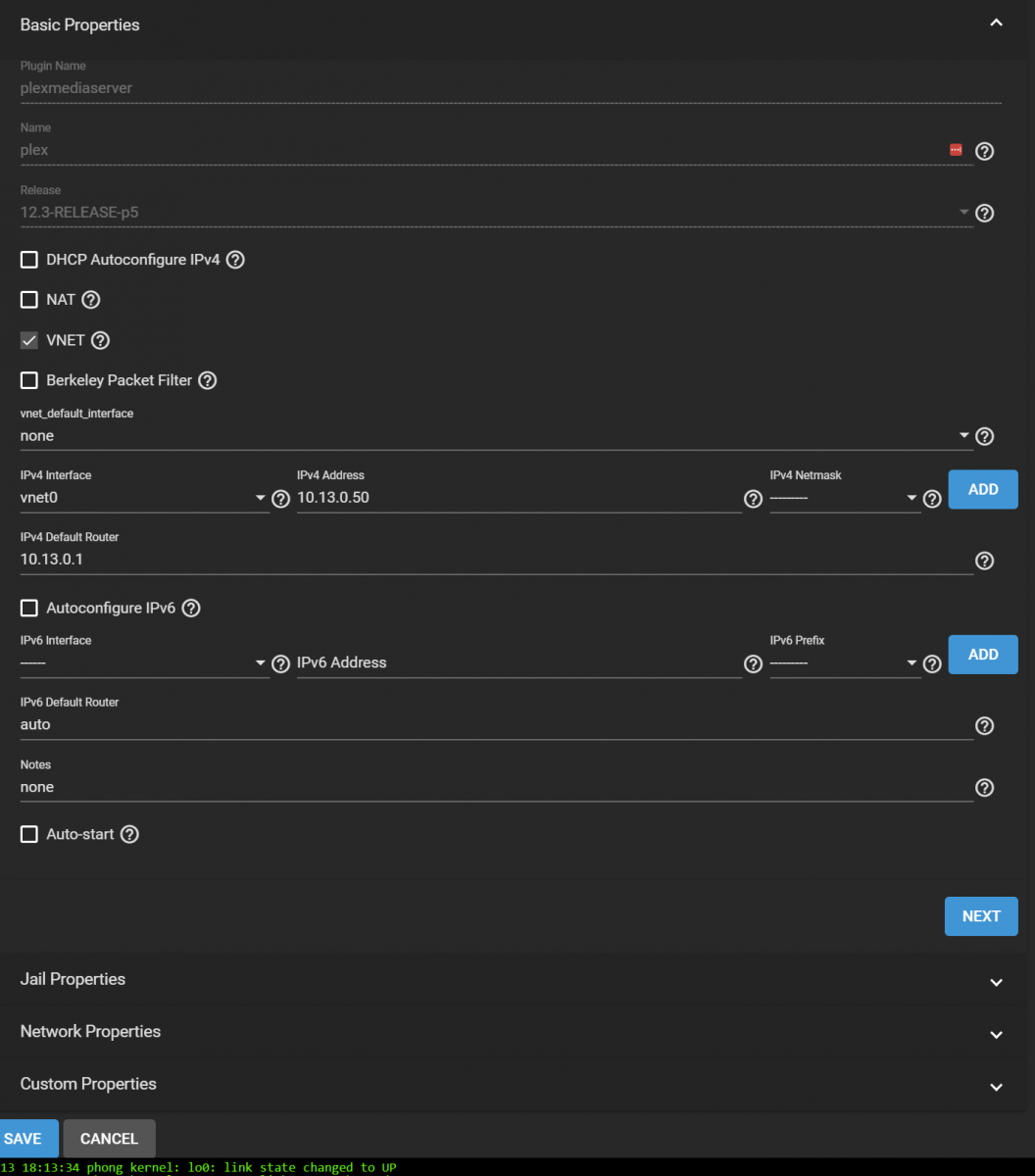

@Patrick M. Hausen, the only selection available under IPV4 interfaces is "vnet0", which I have chosen.
Here are my jail settings:
Here are my bridge settings:
Here are my interface settings:
Here is the output of ifconfig from the shell of the jail:

I found the problem. Thanks to @Patrick M. Hausen for your help. I was editing the network properties of the jail from the first page where ipv4 interface was set to "vnet0" as that was the only option in the dropdown.
I just noticed there was a network tab in the jail configuration. In there, under interfaces, "vnet0:bridge0" was entered (I have no idea when I did this: I had read that bridge0 is a bug, so I had been avoiding it). I changed it to "vnet0:bridge1" and it is working now.
FWIW, I have no idea where anyone got the idea I had been using NAT. I purposefully had been avoiding it and if I had referenced it at any time, it was unintentional
