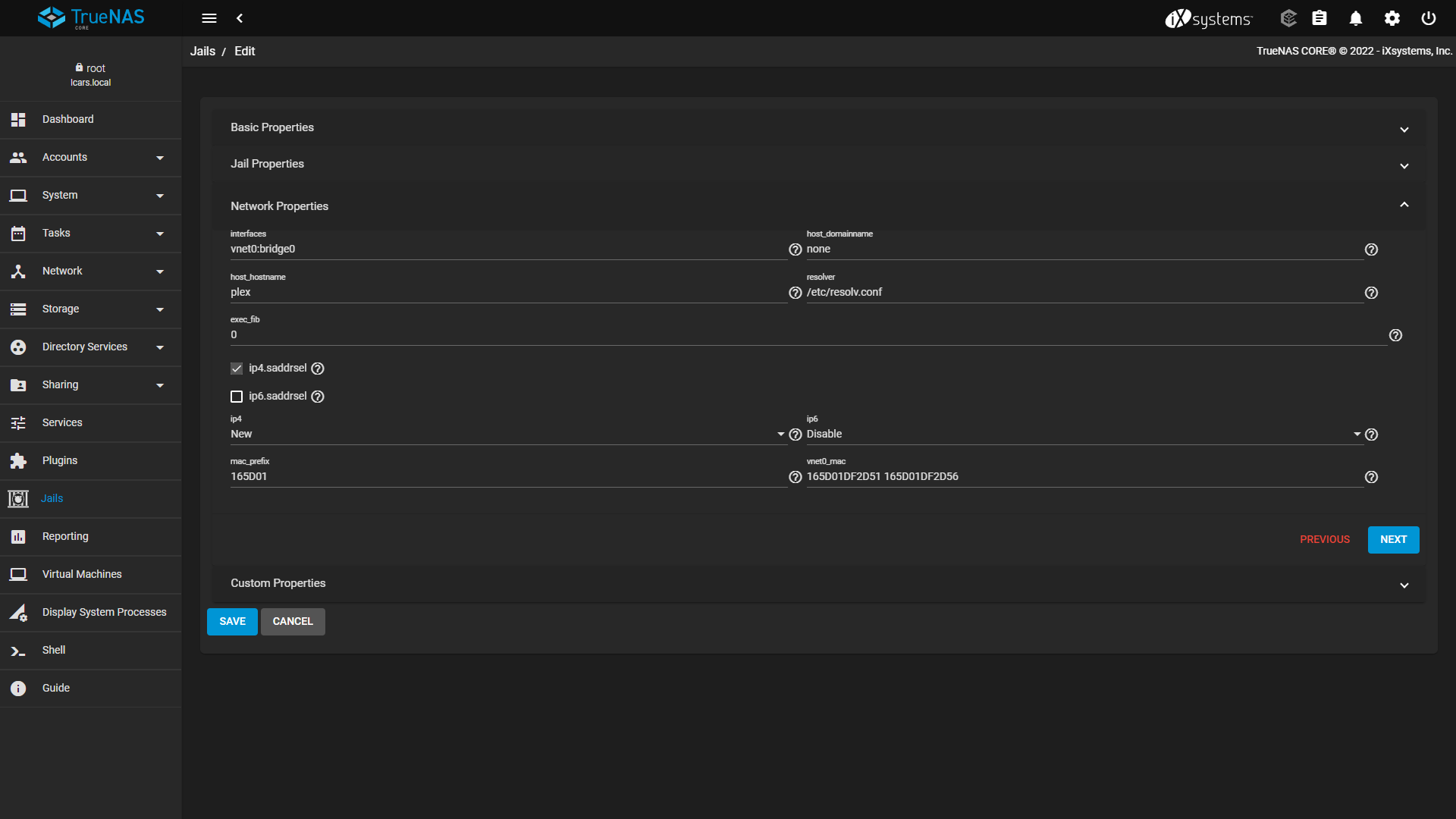

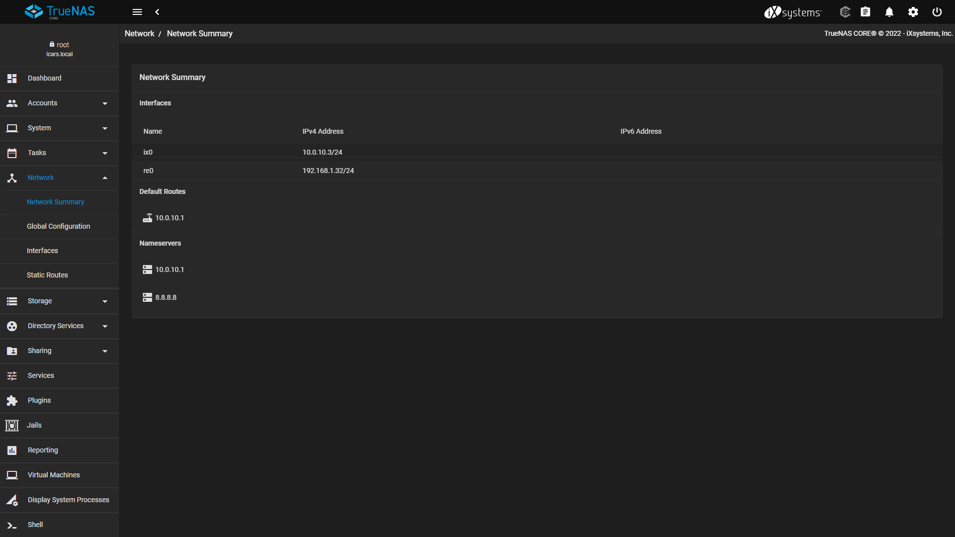

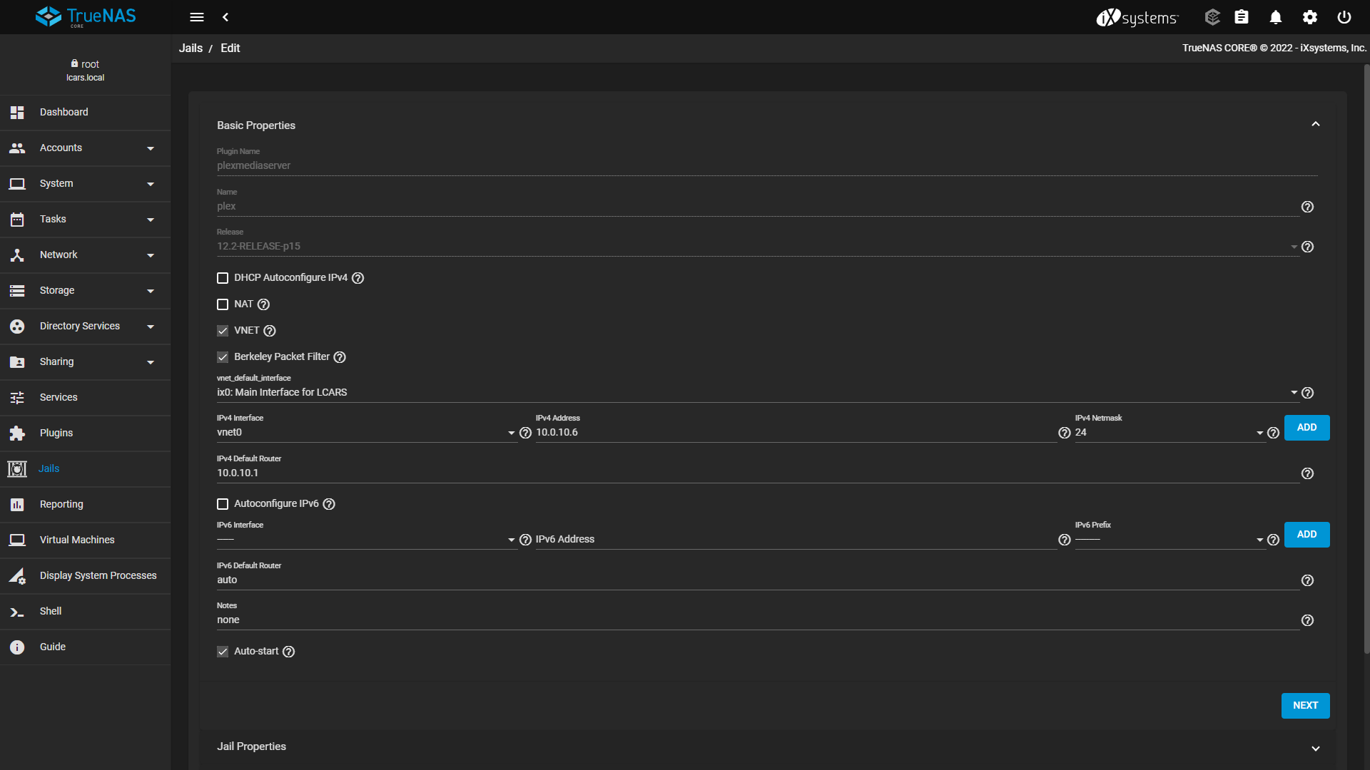

Took some screen shots of the setup incase someone can spot something that isn't right on the jail setup

I think this may be a lead on what finally fixed my issue.
Somehow I had no bridge interfaces, when I created a bridge0 everything in plex started working as expected.
