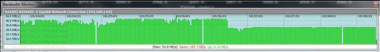

When I left the house this morning I set up iperf and jperf to run for about 10mins, so I should have a good report of that when I get home tonight.

Looks like I have some network troubleshooting first. Did a 5min test when I got home tonight and the speeds started around 45MB/s and they hovered around 48MB/s.

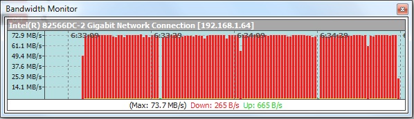

BTW, when I copy a 7.76GB ISO from the FreeNAS box to the windows box I'm getting around 70MB/s. If that helps at all.

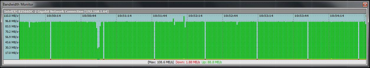

Mine wasn't line speed either so I had to take a look at it (I was new to all this). When I looked at the shell, I noticed it used a TCP window size of 64k. So I went back into jperf and changed "TCP Buffer Length" (in Transport Layer Options) to 64 Kbytes. Bang. 113 MBytes/sec, which is pretty close to max speed (it's about 900mbits instead of 1,000).
OK. I changed the TCP buffer length and got a pretty steady 90MB/s. Good call. So still a little under line speed but much better than the first test.
I also bypassed the switch earlier just to make sure it wasn't causing any problems and got terrible and erratic speeds. I had it back in the mix when I did the test above though.

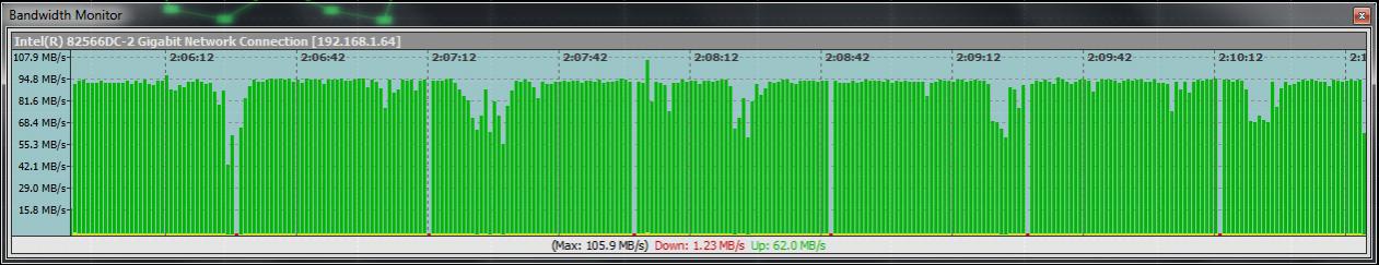

So here's what I've got so far. I removed the RAID card and hooked everything up to the on-board SATA controller, enabled them as just SATA, no RAID in the mother board BIOS. Removed the old volumes and configured a new one with the 6 WD drives in RAIDZ2.
Ran Iperf and Jperf with the 64k window and got the same 90MB/s speed, mostly stable.
