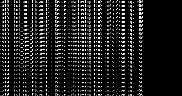

Hi, after upgrading to FreeNAS-9.3-STABLE-201503270027 i am having issue with X710 10GbE SFP+ network card. Freenas is stuck on error:
ixl0: ixl_set_flowcntl: Error retrieving link info from aq, -56 . Added a screenshot. And freenas is not booted properly at all.
Before FreeNAS-9.3-STABLE-201503270027 release the network card wasn't even recognised.
Maybe someone has some suggestions how to resolve this.
Thanks.

You can disable flow control by creating a Tunable of type sysctl, value 0, and variable hw.ixl.fc.
What do you mean by "freenas is not booted properly at all"?

Already tried to disable that tunables, no luck, didn't help. Actually according to man pages of ixl flow control should be disabled by default.
"freenas is not booted properly at all" i mean that freenas is flooding messages os screen. No promt for login or normal freenas on screen menu. Just check screenshot i uploaded.

I can't even get access to shell when booted is this version 201503270027

In that case, reboot into a previous working environment and create a bug report at bugs.freenas.org. Post the issue number here.

I'm betting there was no support for the card, the driver was added but is very new, and now you are left with a driver that is new (and therefore buggy).
