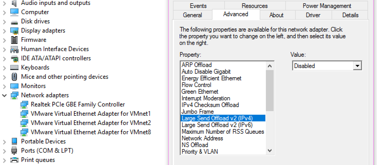

Win 10 workstation with on-board Realtek Gigabit adapter, as per internet info, large send offload has been disabled but performance is still in the woods looking for bear crap.

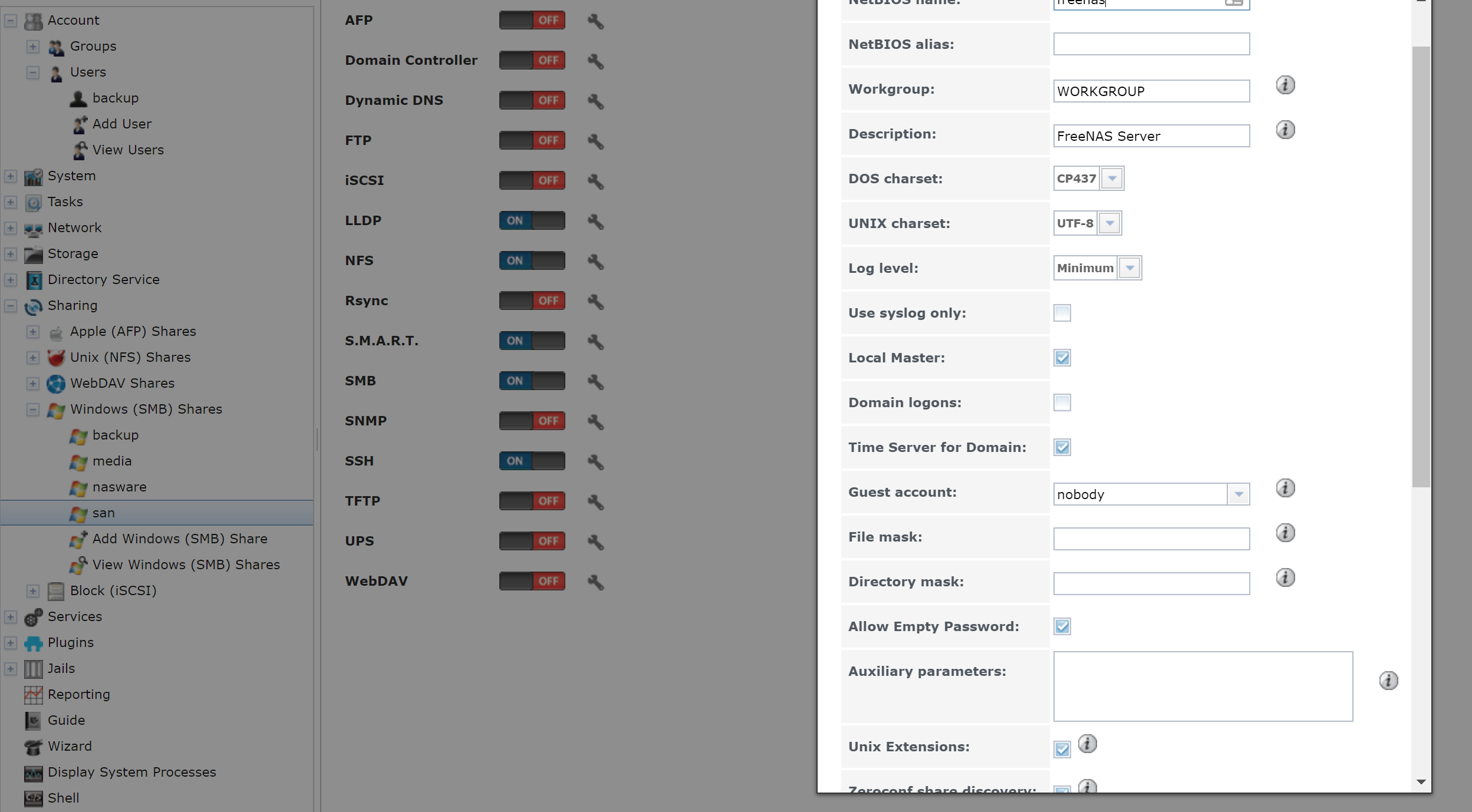

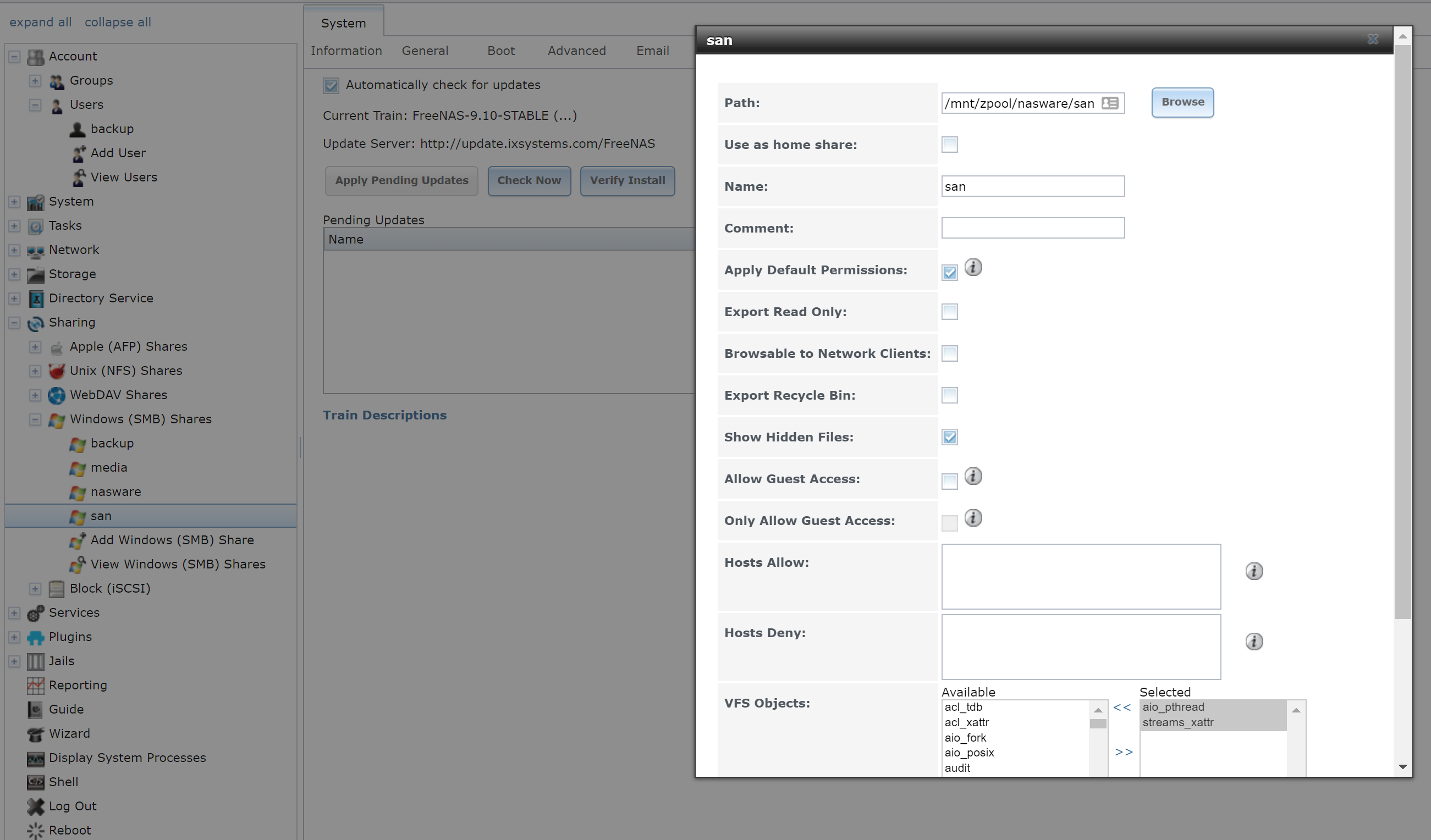

At this point I'm kind of ruling out any bad settings on my part while setting up shares on FreeNAS.

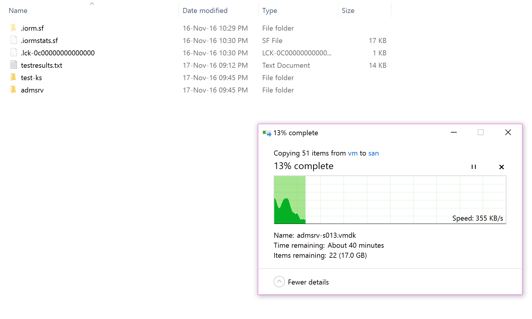

Now what happens when I try to upload files to the CIFS share in Win10 is attached in the screenshot. It starts off ok then it drops off to either 10Mbit speeds or lower.
I'm trying to find out what might be the issue here or how to investigate further since I don't have a clue why uploads using CIFS would be crippled in Win10
