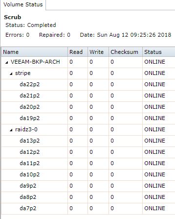

To extend the storage, we bought 4 HDD's of 4TB each and my colleague added them into the volume as stipes which gives the img1.

If it is the case, is it possible to use the current configuration or correct the configuration in some way ? I mean I'm not sure stripes are a safe way to add space to a volume because they are the same as RAID 0 right ? Is there a way to remove the striped hard drives without crashing the whole configuration and configure it correctly or should I take as a fact that I lost the 4 HDD's forever and I'm good to buy X other HDD's to extend the volume ?

In order to extend a RAIDZ3 pool of 1 vdev, you need to back up the content, create a new pool/vdev and copy the content back. There is no online extension of RAIDZ in the way that you were trying to do (maybe coming in a few years, but not now).
You are currently in a risky situation with your pool as you have made a multi-vdev pool of 1 RAIDZ3 and 4 striped disks.
If you lose any one of the striped disks, your entire pool is lost.
I suggest you make a backup, rebuild the pool that you wanted to have (one vdev of RAIDZ3) and restore the backup.

Your colleague really messed up here by failing to understand how to grow the filesystem, and adding those four drives as stripes.

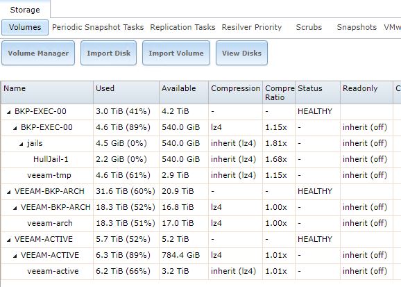

Is there any way to remove the 4TB drives just added in stripes and unused ? the additional storage added with these hasn't been used in any way and it is not integrated into the RAIDZ3 as you may have noticed in the pictures attached to the thread.
