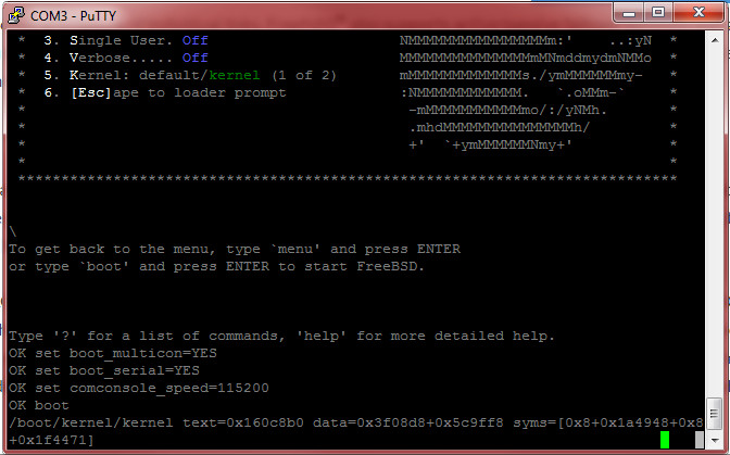

Hello and thank you in advance for your help.
I've been for so long days trying to make work this NAS with multiple NAS dedicated OS, but nothing works properly. I looked into a lot of forums and manuals and FAQs without success. The couple systems that worked were giving me some troubles not hardware related so after some time, I decided to fight the way to install FreeNAS on this thing, as I'm sure it will be really better than the others.
Is my first time dealing with BSD systems, so please have on mind that I'll need some knowledge-handicapped help (thank you again for your patience and any tips & hints you can give me).
The victim is a Western Digital DX4000 Sentinel, a headless server that even has the serial console hidden (you have to solder some cables inside to make the connection). I look everywhere but nothing I found works. I really need help to make this not-that-cheap-thing work. I tried to connect a graphic card to the only PCI X4 it has inside, but it didn't work.
It reach the bootloader, but don't go any further. I'm leaving here a picture of the last thing I see before it stop showing things (add the 'set console=vidconsole,comconsole' line there, I tried that a lot of times too).
I tried from CD with external CD reader and with a lot of USB sticks. Tried to edit the /boot/loader.conf file but I'm still trying to install FreeBSD to access it and edit it, still didn't that.
Thank you again, hope you can help me here...
My Hardware: Intel Atom (1,8 GHz), 4 Gb RAM (Is really mandatory to have 8?), only 2 USB plugs, a serial console plug and a dead PCI X4.
