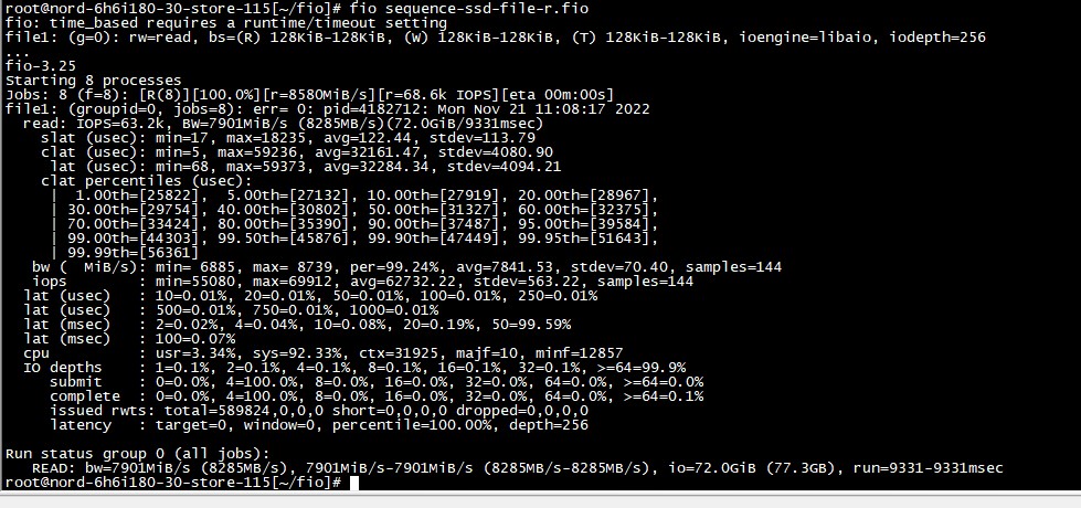

fio test results on the server itself:
Read:

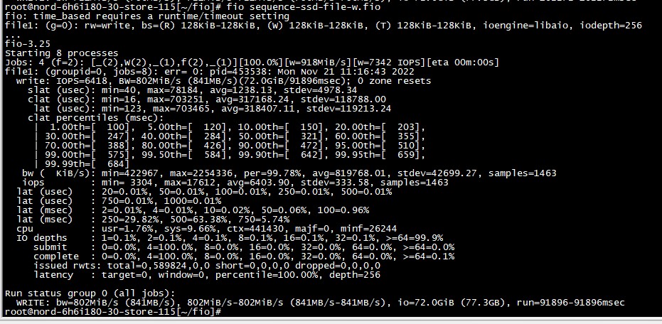

Write:
The record is low because pool 99% busy.
No need to pay attention to the record now.

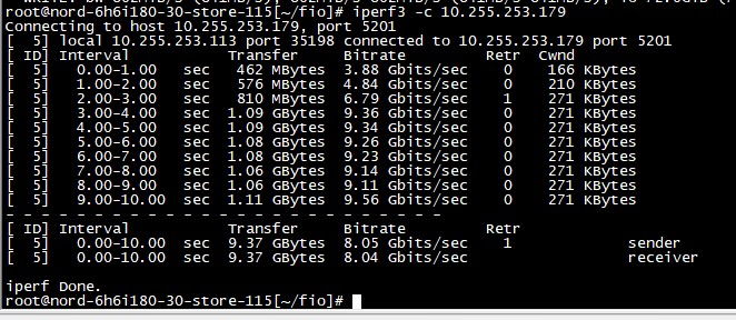

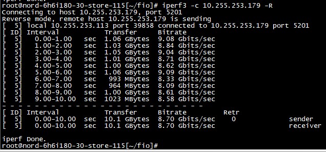

Link speed 10Gbit. iperf3
TrueNAS => ESXi
ESXi => TrueNAS

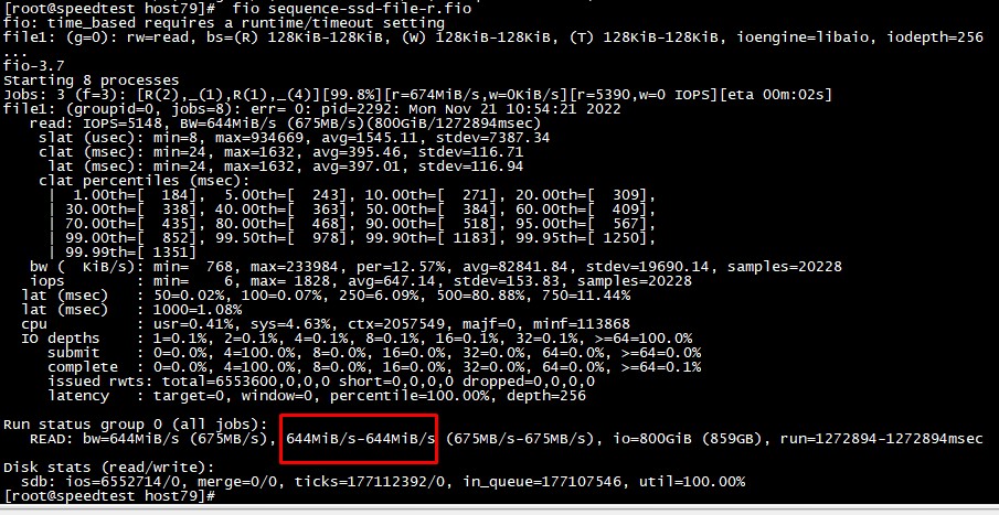

When you test the disk speed from a Linux CentOS 7 virtual machine, you get the following results:
Only this virtual machine runs on ESXi. No Storage policies are used.
iSCSI: No multipath
Read:
Write:
Here you can see that the read speed is almost 2 times lower than the write speed.

- Why is the read speed using 1 channel per 10Gbit 600MB/s? The channel is idle and iperf shows
that there are no problems on the channel and it gives out completely 10Gbit.

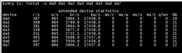

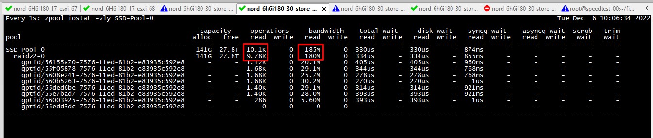

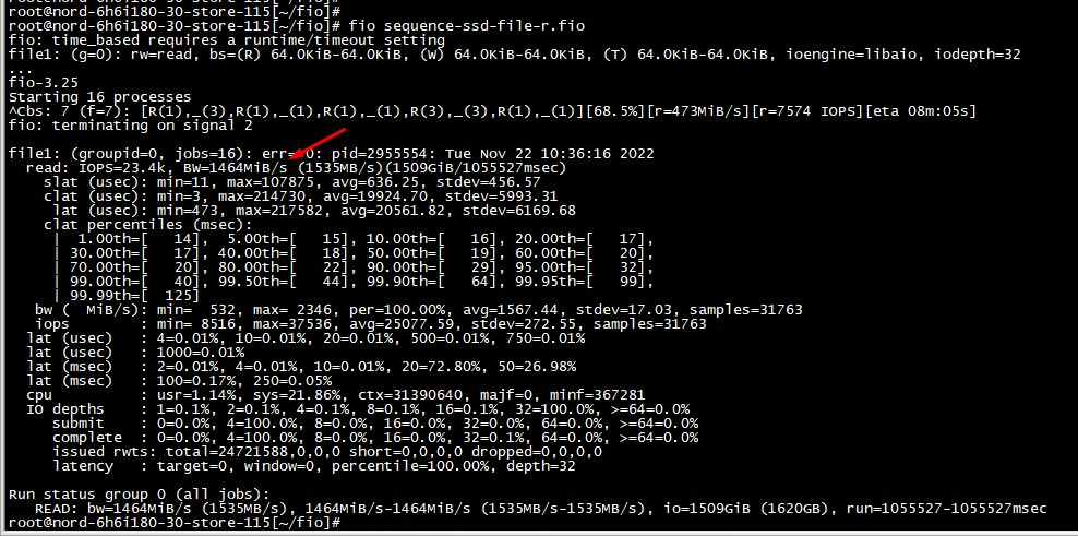

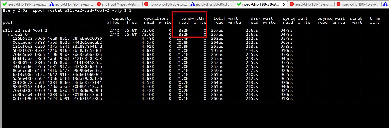

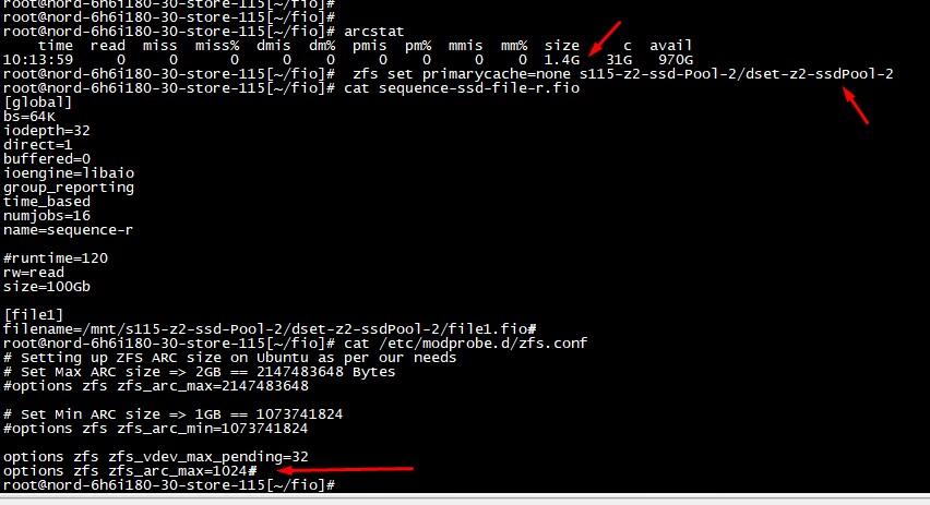

- Why, in a local speed test with sequential reading and cache off, fio shows a speed of ~ 1600Mb / s, and zpool iostat shows ~ 300Mb / s
how is this possible?
I just rebooted the server, the cache is empty and off. I run a simple reading test and get an inexplicable result.

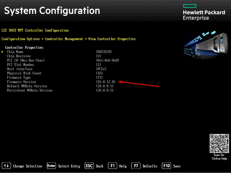

Also, were you running the correct firmware on the 9300? TrueNAS does require a very specific firmware version.
I checked the firmware version (tested 2 months ago, but did not write down the firmware version, just checked) and it did not arouse my suspicions.
I'll be sure to write it down on my next test.

Thank you for your patience and answers to my questions.
"In order to ask the right question, you need to know half the answer"
I find your last post very helpful. Thanks again.
I plan to return the LSI 9300 to the server, check the firmware and test the server.
volff
Jul 21, 2022
10
Hello, I installed the LSI 9300 controller. The firmware is correct 16.00.12.00
Installed TrueNAS CORE 13
Created a pool of 8 SSD drives.
Turned off the cache.
Ran a sequential read test.
Ran zpool iostat -vly .
I read the numbers and they don't beat. Please explain or provide material to explain:
Why is bandwidth so low with IOPs equal to IOPs fio.
How are these numbers calculated?
10,5k(iops)*128k(bs)=1 344Mib
zpool iostat shows 209Mib
