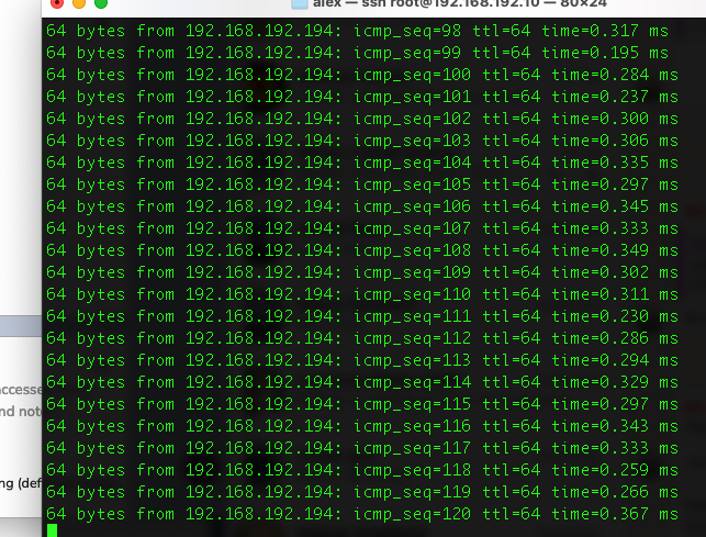

All the sudden (ie for the past day or so) we see connectivity issues for our iSCSI storage hosted on a trueNAS server
I don't see any issue on TrueNAS server (ie nothing in logs / etc).
Ping are "clean" both way (ie Esx to NAS and NAS to Esx)
Any suggestion as of how to diagnose this ?
ESX 6.7u3 vs TrueNAS-SCALE-22.12.3.3. No known config change as of late.
