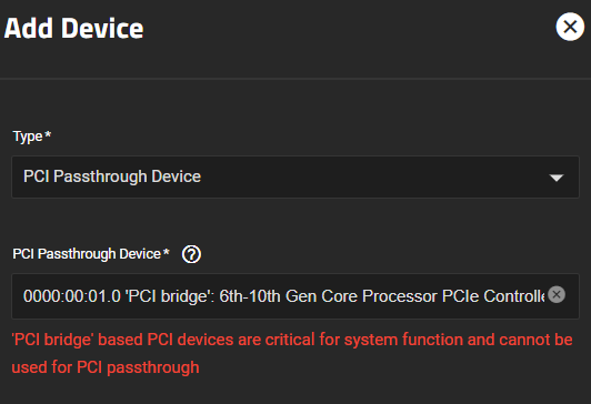

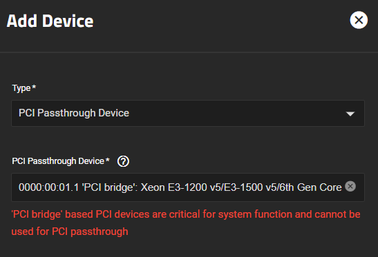

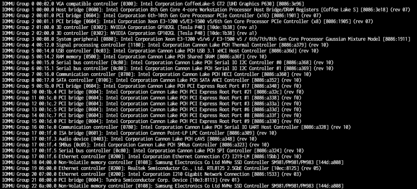

I am runing the latest Truenas Scale Cobia 23.10.0.1 and I have 2x Nvidia Tesla P40 I want to Passthrough to a VM on a Supermicro X11SCA board. I know that the two PCIe slots are in one IOMMU group and I can passthrough the GPU just fine if I only use one. But as soon as I plug in two GPUs the Intel PCIe bridge gets grouped together as well.
AFAIK I should be able to just pass the bridge together with the GPUs to the VM and have it work. But the GUI is preventing me from doing that, is there a way to manually force passthrough a PCIe device? Is there a way to edit the VM config files like in proxmox?
Tesla P40 x2 and Intel PCI Bridge in IOMMU group 2
Truenas is preventing me from passing through the PCIe bridge.

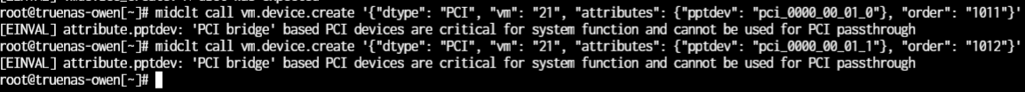

Using midclt to use the API also gets blocked still.
