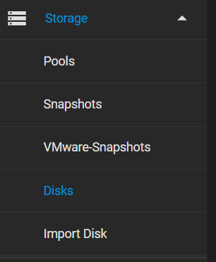

Hello, I have an old HP D6000 enclosure that I'm repurposing for Truenas. It has QTY 70 4TB drives. I'm going into a DL380 Gen 8 with dual LSI 9200-8e HBAs. The Truenas manual says that a "Multipath" option in the menu will be enabled when multipath exists. I don't have that option.

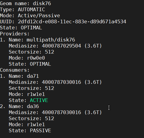

It seems like multipath is working. All 70 drives are seen by Truenas in the GUI. At the CLI they all look something like this attachment, all disks are "OPTIMAL". Can I assume that multipath is working even if the option doesn't show in the GUI?

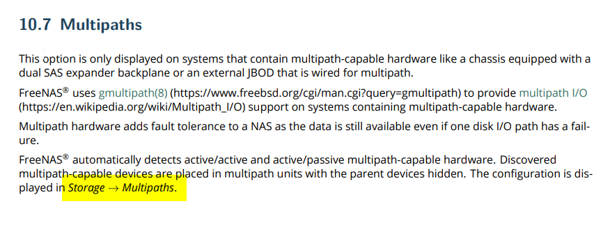

Perhaps you can share the page of the manual you're looking at. I don't see it:

My bad. It looks like I didn't realize that I was reading the Freenas 11 manual. The Truenas manual doesn't mention this (even though I swear that I saw it show in the Truenas UI at some point). My question still stands though, if it says "Optimal" is multipath correct and is Truenas using it? Thanks!

The line from the Freenas manual says "discovered multipath capable devices are placed in mulitpath units with parent devices hidden". When I look in Truenas UI, I see the raw disks at daX, I don't see the multipath label of "diskX".

The 11.x manual isn't applicable for 12.x or 13.x. Multipath UI support didn't get carried forward for 12.x or 13.x, because it just ended up confusing users. Indeed, there have been some nasty bugs found in the 12.x UI, which displayed passive members of multipaths as available for constructing pool VDEVs. See https://www.truenas.com/community/t...-zpool-in-creating-another.97421/#post-672712.
For your own sanity, I suggest you create a LOADER-type tunable in System->Tunables with variable geom_multipath_load and value NO, and then rebooting to disable multipath.

The 'Multipaths' tab will only appear once you have made a pool out of one or more multipath devices
