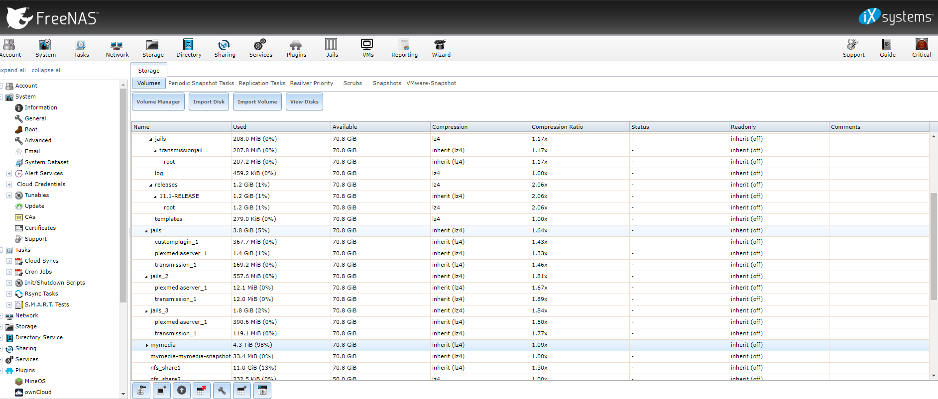

I followed your instructions then I changed my jail>configuration from /mnt/tank/jails to /mnt/tank/newjails_location, and when I check the newjails_location dataset to see if there's any file transferred but there was zero file on the new Jail Root: jails_pool_new so what I did was reinstalled all the plugins.
sent 8.48M bytes received 65.69K bytes 813.89K bytes/sec
total size is 13.43G speedup is 1,571.73
root@freenas:~ #
As you can see, jails are still on the original location. Pls see attached screenshot.
i have a few jails that I wanted to migrate including jails_2, and jails_3 and then after the migration is complete I want to delete them completely from original location.
