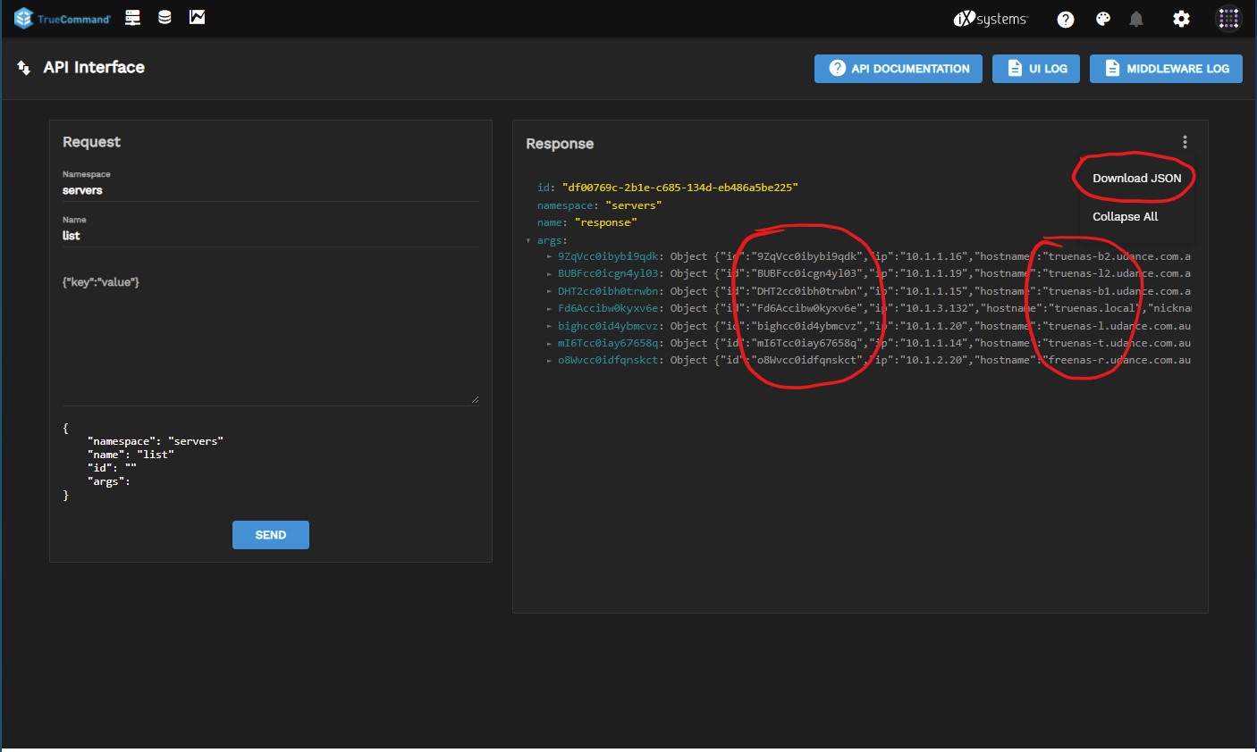

Yes, if all contact with TC is lost abruptly. Without any patches to TC, you can already use TC's servers/list (namespace/name) API to find the system ID -> NAS address (or nickname) mappings. But you'd have to keep track of these manually for now.
Nice! Workable!
