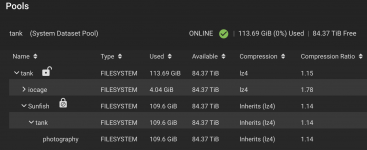

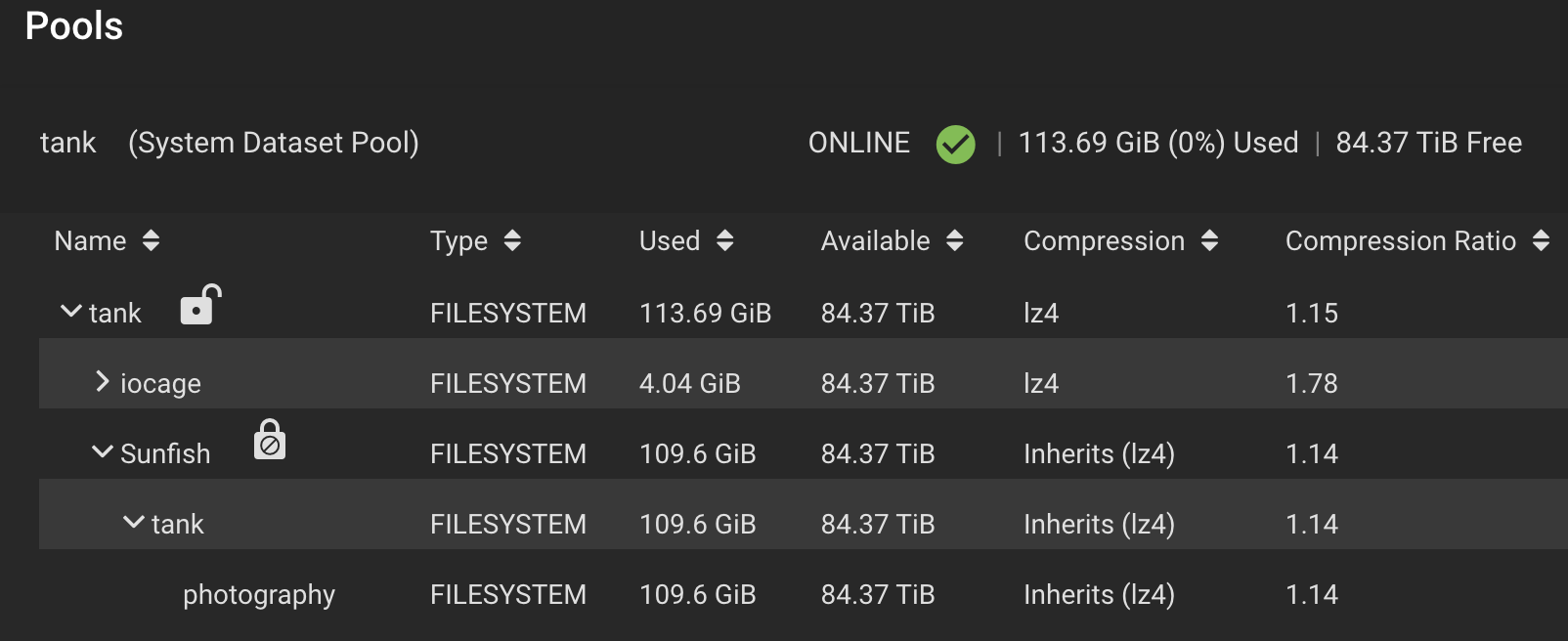

On the receiving end, it is set up as fan in so stores the receiving datasets like this:
tank/$HOST/$POOL/$DATASET
I would prefer I could control the exact source to destination position but not the end of the world.
I found out that the replicated datasets are not mounted at the other end, that is fine but whatever you do, don't mount them otherwise you change the remote dataset and then the backup cannot continue due to diverged data. If you want to mount the dataset to check on it, clone a snapshot and mount that instead.
