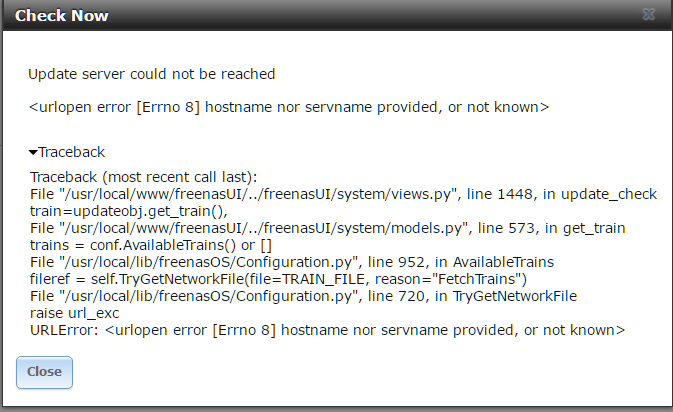

Ok so now i have only one cable connected to LAN1 and I'm able to get into the WebGUI.
Can't get into IPMI ip though.
One more thing i noticed is that i can't communicate with the internet (something i could have done previously when my ip was inside DHCP range). Tried checking for updates just to see i can get a connection and got this:

Basic networking requires
IP address
Net mask/subnet
Gateway
Nameserver(s)
You can plugin your ipmi cable. That has no bearing on your other NIC

Where do i fill that? In Network>Global Configuration?
The subnet is 255.255.255.0
The Gatway (router ip?) is 192.168.10.1
Shouldn't i use DHCP to get IP for connecting to the internet?
How do i know the Nameservers?
And how come it worked earlier without any config and now it stopped?
I feel so ignorant...

Do yourself a favor and take a few minutes to familiarize yourself with networking basics.
http://doc.freenas.org/9.10/network.html
There is nothing special or magical about DHCP that would require it to access the network or internet. A DHCP server merely assigns an IP address and sets a few settings, all of which you can set yourself.
Your router is your gateway. It's probably also your network's DNS server (nameserver).

Even though I've gone over that document several times, only now i managed to configure it correctly. I can check for updates and I've sent a test email that i got.
