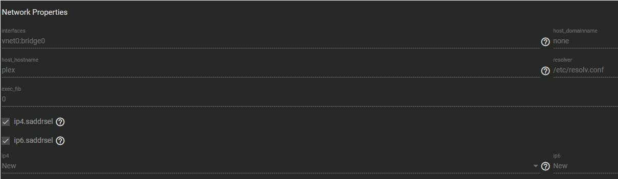

NAT is not enabled for the jail, VNET is:
I haven't changed anything on the network settings of the jail, I think:

I agree, those network settings seem simple and reasonable.
