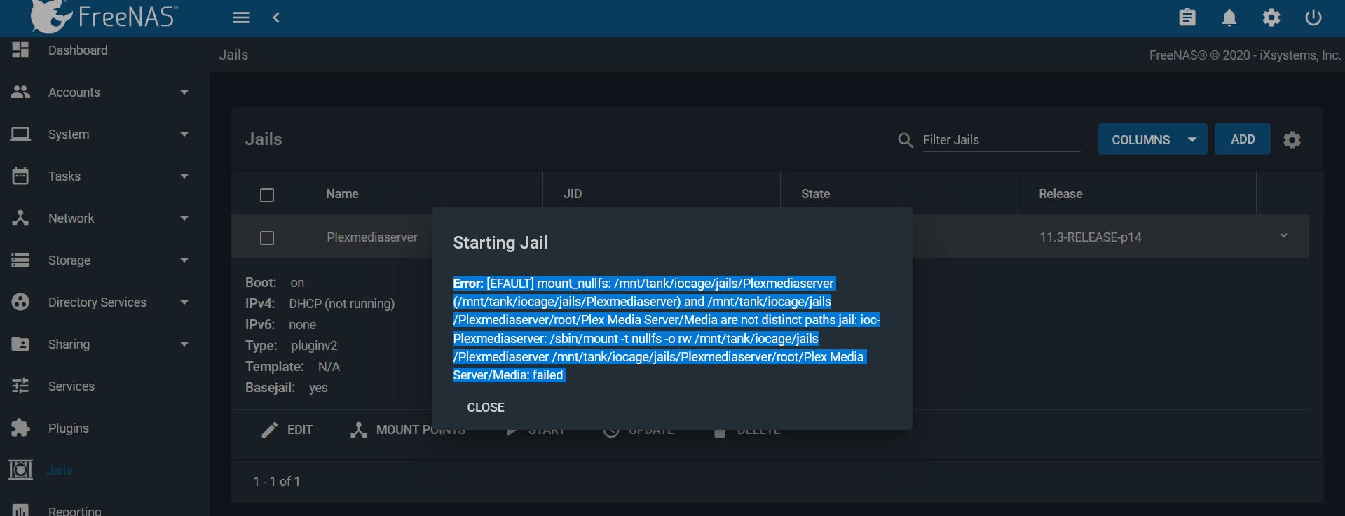

Hi everyone,
Got a question for everyone regarding the Plex Media Server setup for a TrueNAS Mini 3.0 system.
After following the guide for installing a Plex Media Server from YouTube FreeNAS 11.2 - Plex Media Server Plugin, I got to 7:03 in the process where I need to restart the jail after selecting the source (
/mnt/tank/iocage/jails/Plexmediaserver) and destination (/mnt/tank/iocage/jails/Plexmediaserver/root/Plex Media Server/Media) for the Mount Points. But I receive an error message when I try to start the Jail that states the following:
Error: [EFAULT] mount_nullfs: /mnt/tank/iocage/jails/Plexmediaserver (/mnt/tank/iocage/jails/Plexmediaserver) and /mnt/tank/iocage/jails/Plexmediaserver/root/Plex Media Server/Media are not distinct paths jail: ioc-Plexmediaserver: /sbin/mount -t nullfs -o rw /mnt/tank/iocage/jails/Plexmediaserver /mnt/tank/iocage/jails/Plexmediaserver/root/Plex Media Server/Media: failed
What does this mean and how can I restart the Jail to get access to the Plex Media Server again? Any help would be greatly appreciated, thanks in advance.

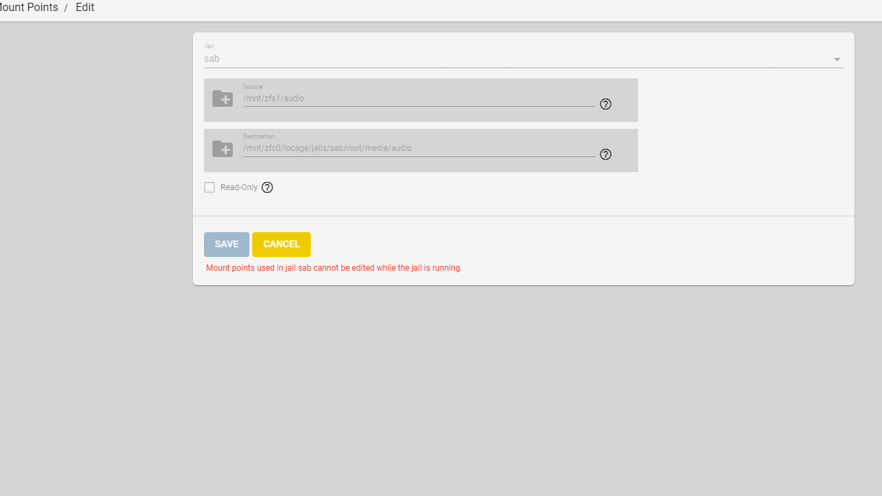

So you are doing it wrong you are trying to mount what amounts to a directory to itself. In the source directory you to select your media location.. In destination you choose the location within the jail. For me this looks something like this.

@John Digital, thanks for the info! I've updated the source and destination path to what you showed on your photo and that seems to have worked. Plex Media Server is connected and updating the media right now. Much appreciated!
