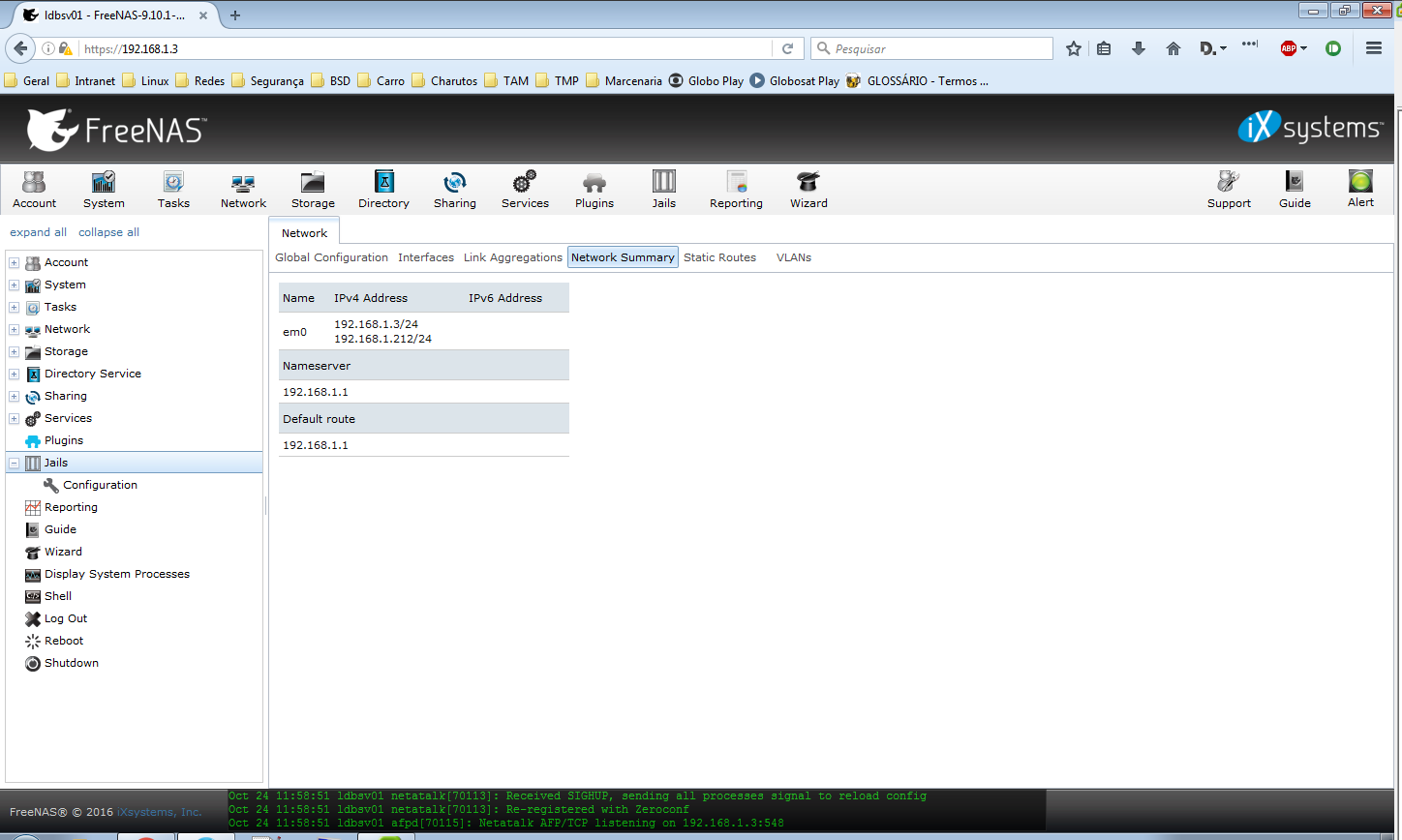

My network interface is showing 2 differents IPs addresses... Why and how can I fix it?
The correct IP is 192.168.1.3/24 and it is static.

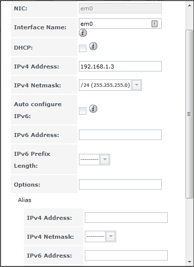

Edit em0 under 'Network->Interfaces' and make sure you don't have an alias defined there.

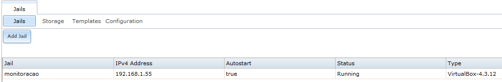

pasiz
Oct 3, 2016
62

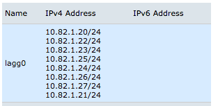

Do you have any jails or plugins running.
Those are creating alias when vimage is not set.
like this:

Ifconfig output?
# ifconfig
em0: flags=8943<UP,BROADCAST,RUNNING,PROMISC,SIMPLEX,MULTICAST> metric 0 mtu 1500
		options=98<VLAN_MTU,VLAN_HWTAGGING,VLAN_HWCSUM>
		ether 00:0c:29:c5:8f:f5
		inet 192.168.1.3 netmask 0xffffff00 broadcast 192.168.1.255
		inet 192.168.1.212 netmask 0xffffff00 broadcast 192.168.1.255
		media: Ethernet autoselect (1000baseT <full-duplex>)
		status: active
		options=600003<RXCSUM,TXCSUM,RXCSUM_IPV6,TXCSUM_IPV6>
		inet6 ::1 prefixlen 128
		inet6 fe80::1%lo0 prefixlen 64 scopeid 0x2
		nd6 options=21<PERFORMNUD,AUTO_LINKLOCAL>

is vimage enabled on jail?
It was enabled... I just unchecked... Do I have to restart the server to check if the IP is still set?
