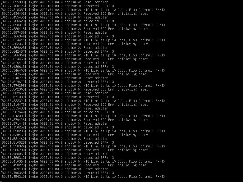

When I try to enable DHCP or create a static IPv4 address for the SFP+ card, I get the following errors which repeat each other every second. I am only able to make it stop, once I revert to the old configuration.
These are the errors / see print screen attached:
  • "NIC Link is up 10Gbps, Flow control: RX/TX"
  • "Received ECC Err, Initiating reset"
  • "Reset adapter"
  • "detected SFP+: 3"
Even without an IPv4, it still looks like it is up in the overview of TrueNAS, however, the only traffic that it is using are some bits or at maximum Kbits.

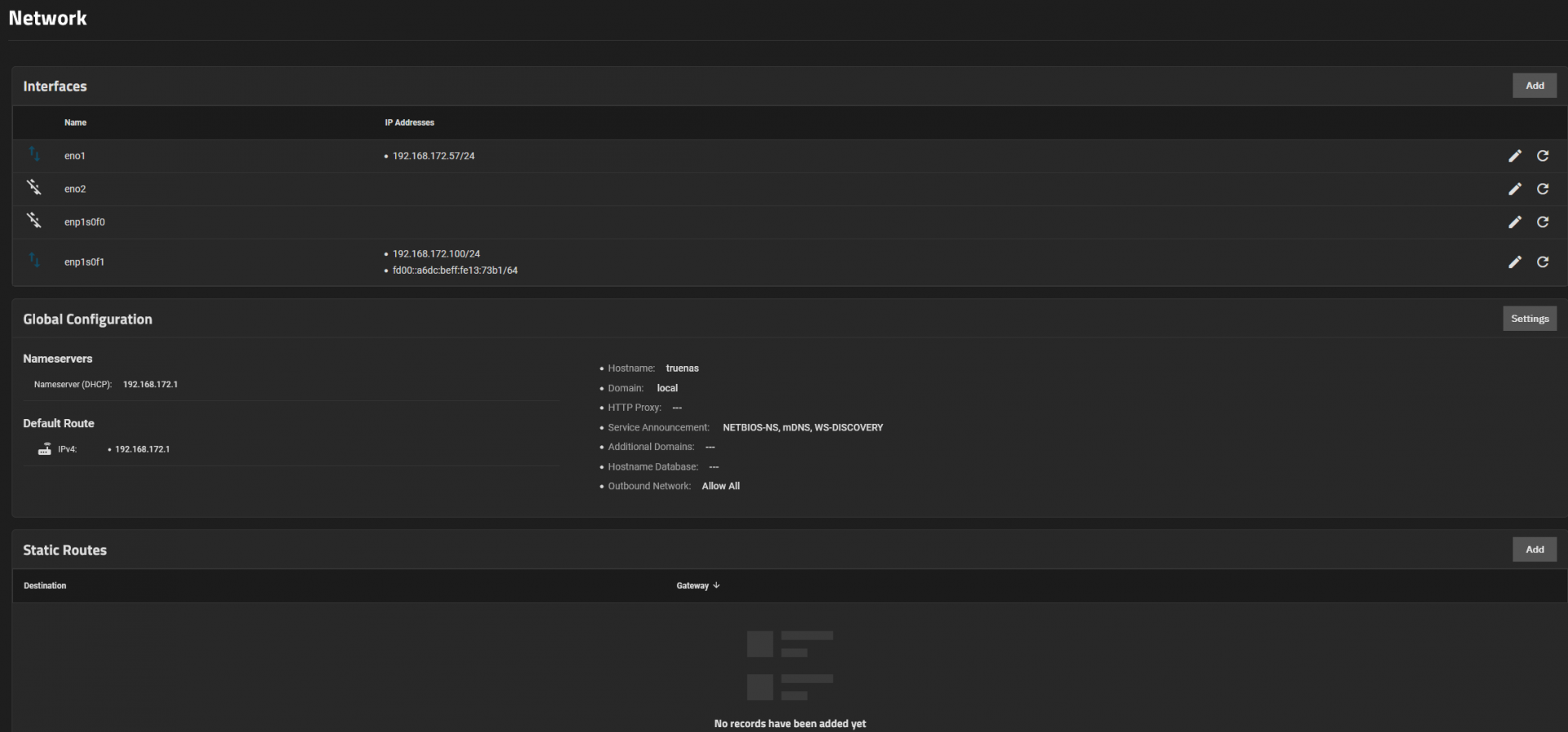

Originally I had the issue above, but now I have a new one. I was finally able to make the Network card work, but now it only is used when I save files to the NAS. When I try to retrieve them, it only uses the 1Gbit connection. I tried to search for the solution and checked the networking part of the web interface, but with no results.
When I unplug the 1Gbit connection from the switch, both IP (the 1Gbit and the 10Gbit one) addresses stop working.
Does anyone know how I can solve the situation? Many thanks in advance for your assistance.

You have both NICs in your TrueNAS box on the same (172) subnet. At the very least you need to assign one of them to another subnet - the rest of the fix depends on your network setup.
Etorix
Dec 30, 2020
2,134
You have multiple interfactes on the same network. Don't do that! Plug only one port.

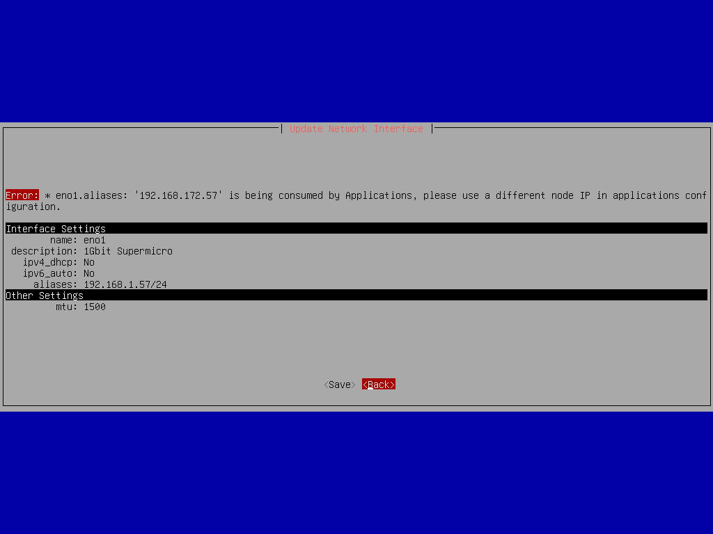

Thank you both for your input. I have tried to change the IP so that the subnet is not the same, however, I get the following error.
I don't know how to change the applications to use the other interface or IP address. If I disconnect the cable from the 192.168.172.57, I lose access to the server. No ping, no web guy, until I reinstate the 1Gbit link.

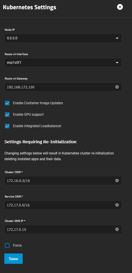

Did you check Apps -> Settings -> Advanced Settings and then node IP?
Johev
Nov 26, 2014
107
Thanks for the pointer. I have checked and this is what I get:
I have even tried to change it to this (see other print screen), however, it does not allow me to change the sub-net of the first network card.

I'm not too experienced with apps but I use scale. Under node IP, where it says 0.0.0.0, can you change it to the IP you want to keep in the subnet? Maybe you need to shut down your apps before making changes to the networking.
