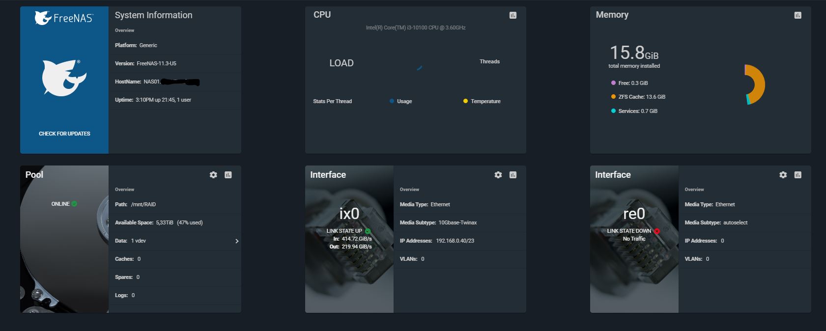

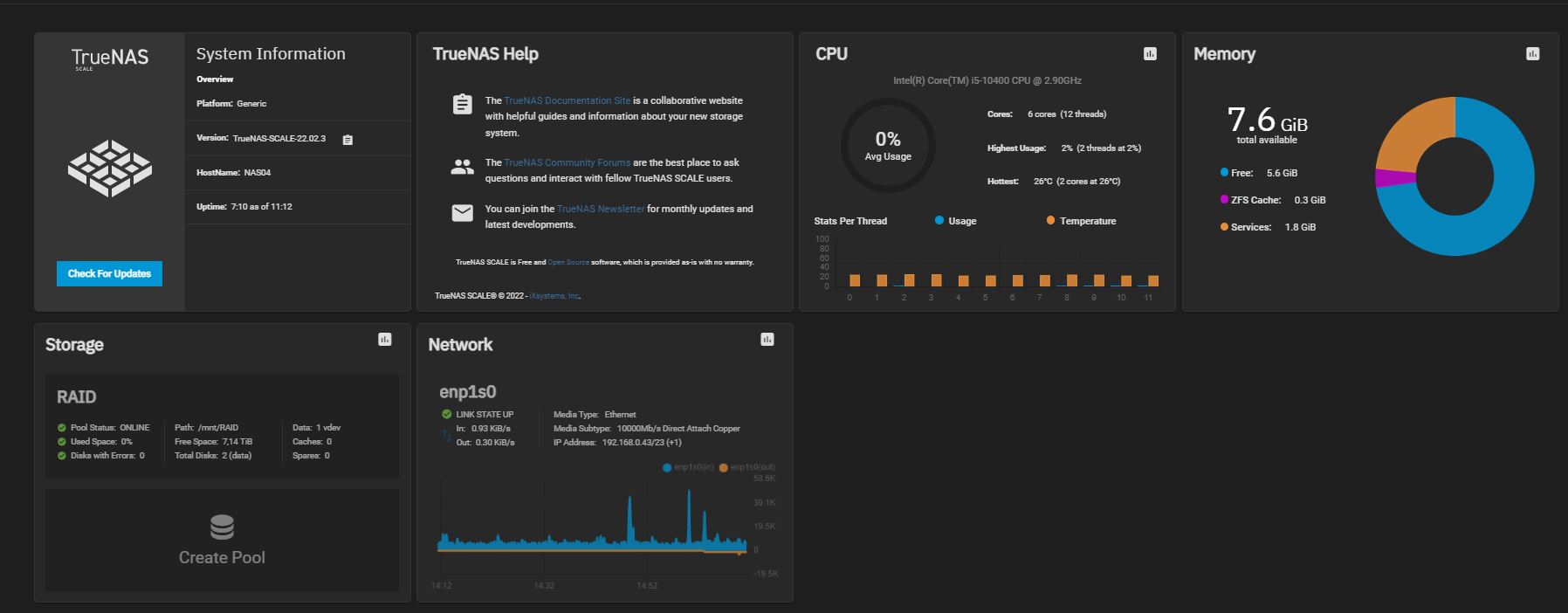

Hello friends. Buy this 10 GB/s Inter x520 card. The system detects it as 10000 Mb/s but when testing it works as 1000 Mb/s. I'm testing by running an Rsync from a FreeNAS (FreeNAS-11.3-U5) to a TrueNas SCALE (TrueNAS-SCALE-22.02.3) both with the same network cards. Any help?

SweetAndLow
Sweet'NASty
Nov 6, 2013
6,421
Is it showing up as 10gig on each end? How are you testing speeds, are you using iperf?

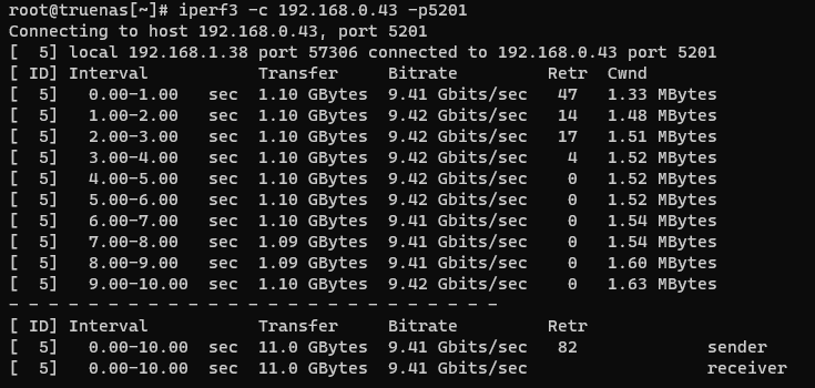

Rsync is super slow, you should start by testing using iperf that will tell you what the max throughput your networking setup can do. From there the slowness probably comes from your cpu or pool configuration.

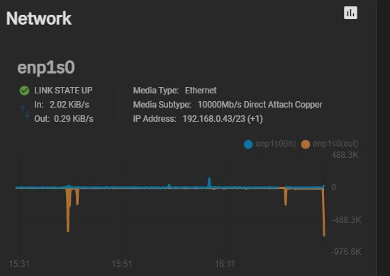

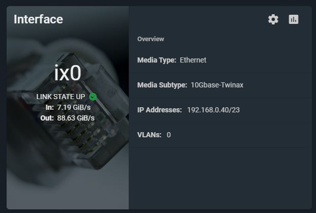

Hello friends. I found the problem, it is that FreeNAS does not take 10GB/s cards, rather it detects them but they do not work at 10GB/s. In my scenario I had a TrueNAS Scale and a FreeNAS. The transfers worked as if I had a 1GB/s card. Raise another TrueNAS Scale in a virtual one and here is the proof: :smile:
TrueNAS to TrueNAS runs accordingly at 10GB/s. It's time to update all FreeNAS to TrueNAS haha
