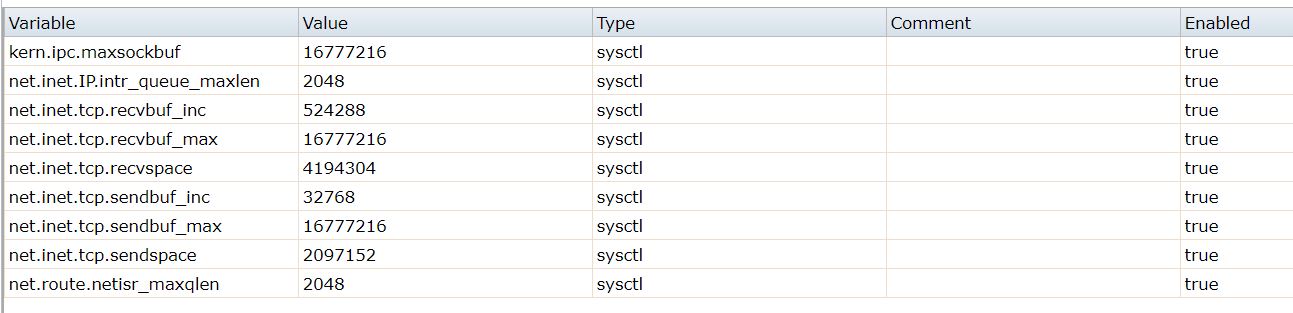

I use my freenas box to store and edit photos through a windows share to my main computer. I wanted to upgrade this link so I purchased 2 Intel X540 NIC's. I wired the two up directly and only got gigabit speeds. Suspecting the cheap Ethernet connectors from the hardware store, I upgraded to tool-less shielded connectors from cable matters. Hooked those up and no connection. Found out that the cat 6a wire I pulled was 28 AWG and therefore too thin to work with the connectors. So I upgraded that to a 23 AWG S/FTP cat 7 cable. I put new connectors on, and things connect but just a gigabit speeds. For the life of me I cannot figure out what is wrong. I've scoured the forms and cant find anything that has worked. Any input would be appreciated!

I would also say don't try and "tune" things until you are sure it is working. After things are known to work correctly you can try fiddling with stuff but honestly unless you have a bunch of vDev's or SSD's or SLOG the tunes will probably do little with a 10G connection.

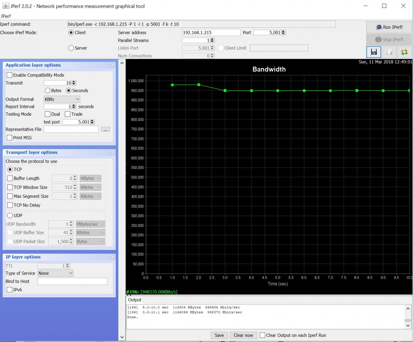

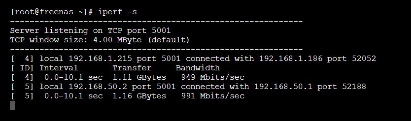

Good idea, but I did think of that. The iperf result I posted was on the 192.168.50.X subnet which a configured for the direct link. Attached is another iperf result on the 192.168.1.X subnet that runs though my switch.
Any other ideas???

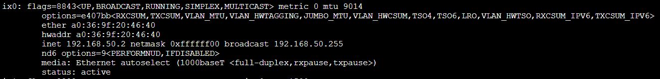

I just re-read the post by @stefanb and his issue makes it sound like less of a cable issue and more of a hardware one. With the hardware thought, I double checked the ifconfig and didn't see anything that jumped out.
c32767a
Dec 13, 2012
371
That ifconfig shows the ix0 interface linked at 1000BaseT, which is 1Gb/s and is consistent with the iperf results you're getting.

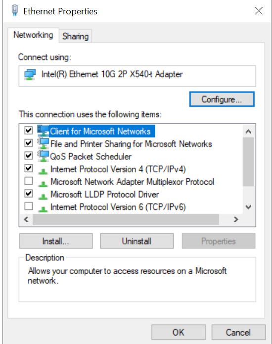

I'm currently at work, so short of taking photos of the cards I did remote in and take some screen grabs from both the windows side and the freenas side of the drivers. See attached.

Ok, so the cards both identify as 10G.. That's a good sign.. :)

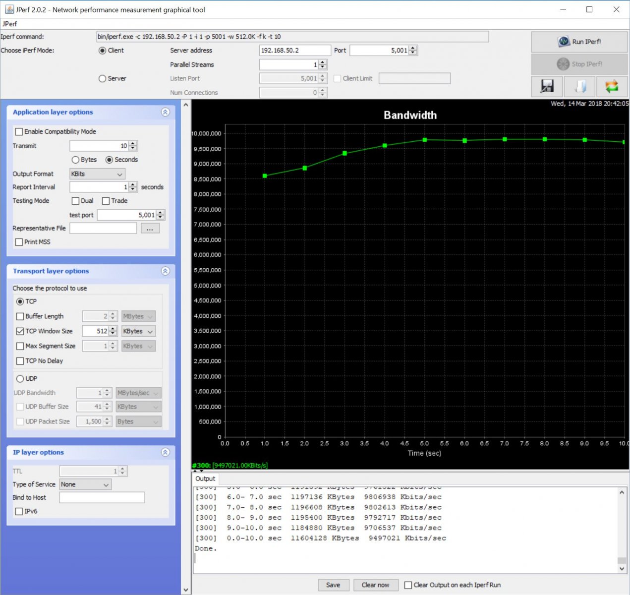

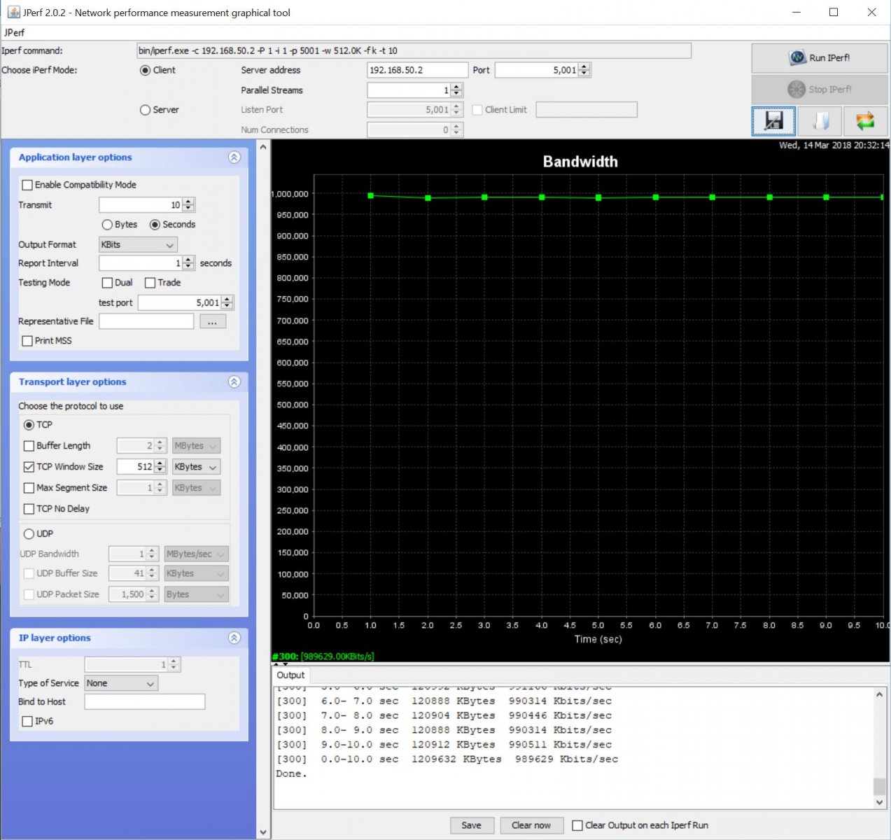

Just got home and opened my amazon package (got this cable), plugged everything in aaaaand no dice. I got the same gigabit speed that I have been. Windows negotiated a 1Gb connection and jperf shows the same. I've attached the results (jperf3).
Out of frustration I deleted the network interface in Freenas and started from scratch. My intel card has two ports, so i switched ports and redid the network interface. then sure enough, windows shows a 10Gb connection, run jperf and see for yourself (jperf4). I even used the old cables I had already run through the walls with the same result.
Ultimately, I don't know what the issue was. If someone else is having similar issues, my advice would be to start again from scratch before buying yet another cable. Also, a shout out to @c32767a and @nightshade00013 for their input. Without you guys I wouldn't be able to mark this one solved!
