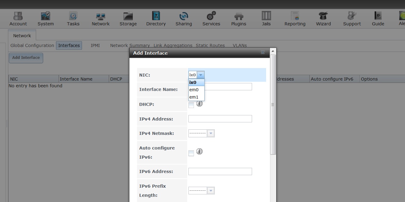

With the card installed in your FreeNAS machine, log-in to the GUI
and go to Network > Interfaces > Add Interface
When the window appears, click on the drop down box at the top.
If your card is recognized the ports will show in the drop down.
My two unused onboard ports show in picture as em0 & em1.
