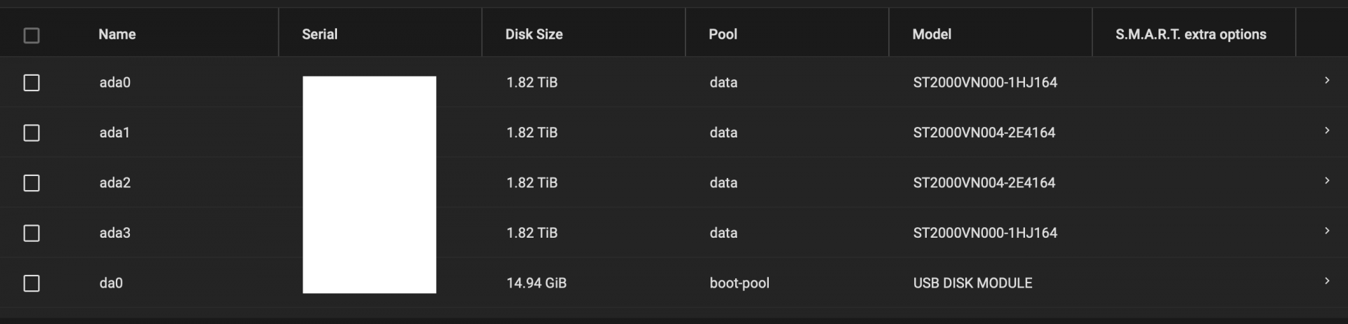

I am pleased to report I installed a 16GB SLC eUSB DOM in the TS-453A and re-installed TrueNAS-12.0-U4 CORE.
Steps:
1. Save config via GUI (export secret seed)
2. Manually backup /root/.ssh/ folder
3. Install TrueNAS CORE on DOM (UEFI mode)
4. Restore config via GUI
5. Restore /root/.ssh/ folder
Boot times and GUI navigation is not any different than running off the external USB3 Crucial X8 M.2 SSD.
TS-253A is next!
