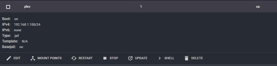

Ping google find
JAil would not start
Boot:
off
IPv4:
DHCP (not running)
IPv6:
none
Type:
jail

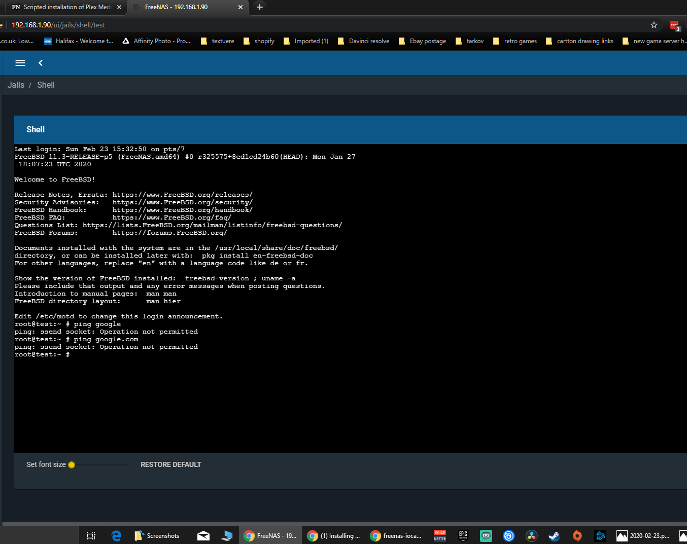

Are you trying those pings from the shell inside the jail?
by clicking on "Shell" as shown just above?

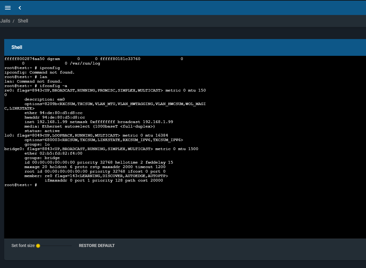

I tried traceroute -n 1.2.3.4 "icmp socket: operation not permitted
network detail within the jail

Try "ping google.com"
There's a possibility that your realtek lan port is letting you down here.

The only time it doesn't ping is when I using shell within the test jail

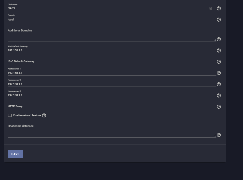

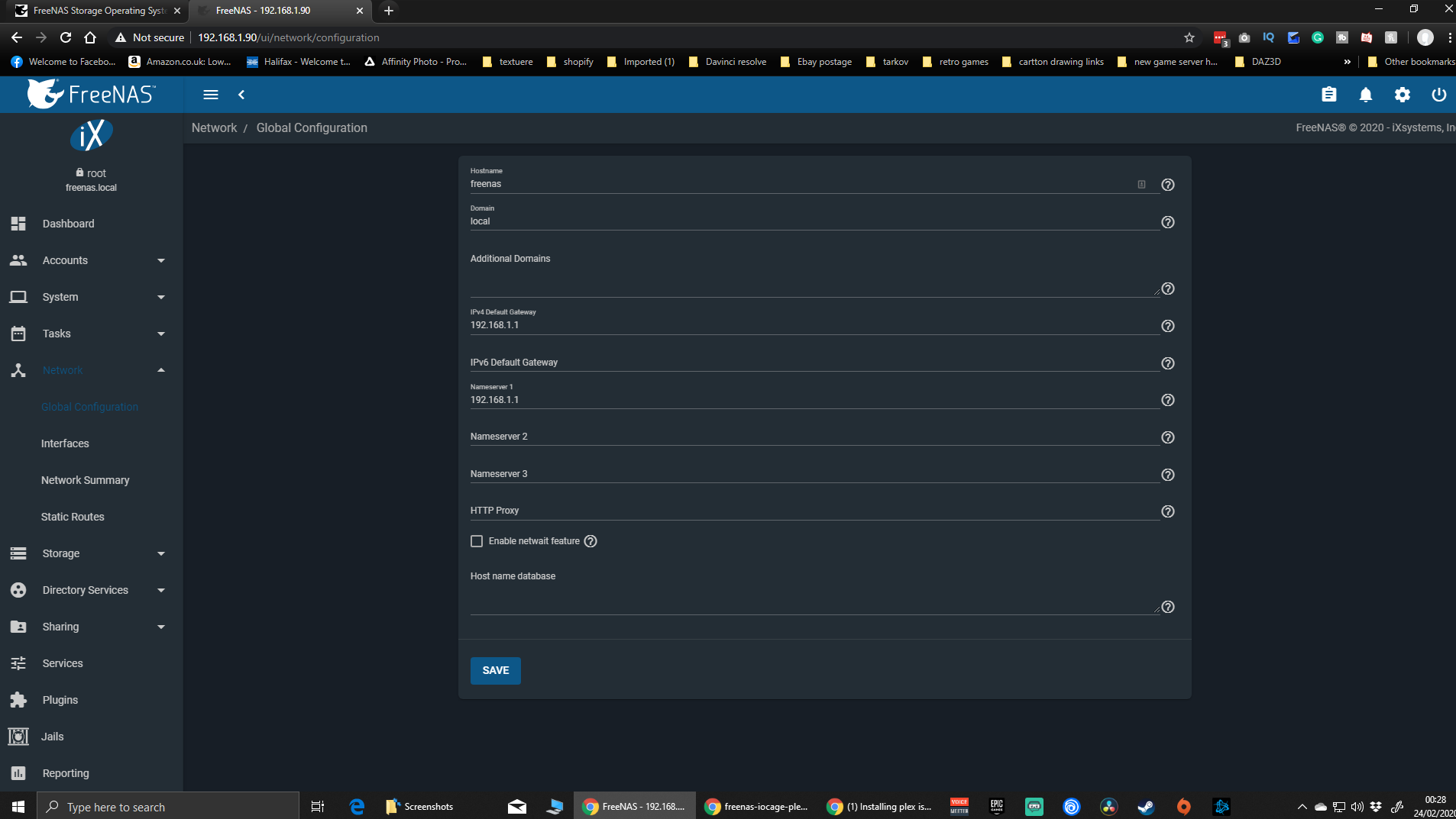

Your network configuration is screwed up somewhere.
What's Network, Global Configuration look like?

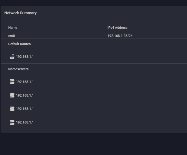

Redcoat
Feb 18, 2014
2,925
And Network, Network Summary:
Deanmrd
Feb 22, 2020
50
ok so I change everything on my so it matched yours apart from the name still not able to ping google within the jail

SweetAndLow
Sweet'NASty
Nov 6, 2013
6,421
Step 1 remove the realtek nic, step 2 why do you have a /24 and a /32. That seems crazy to me. I would reset everything
