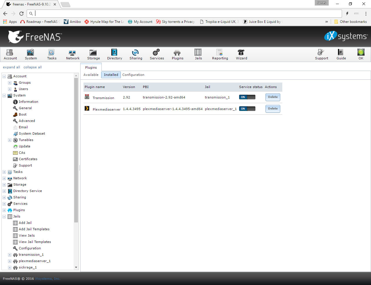

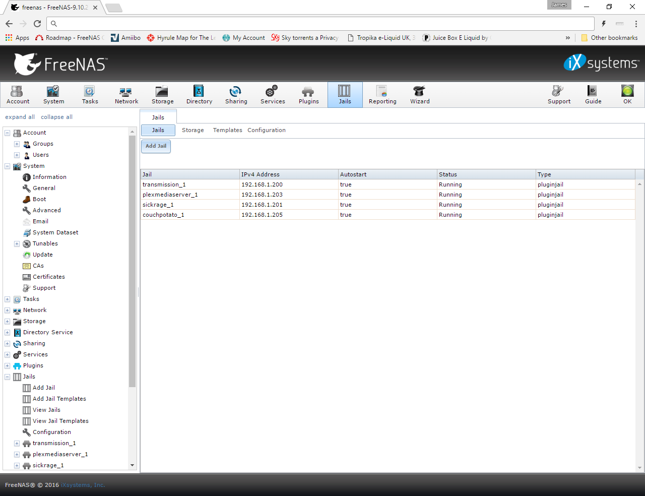

I have an issue, as you can see from the screen shots i have 4 jails installed these were installed via the plugins, and i can access these jails and they are kind of working but when i go to installed plugins, they are not there
is there a quick fix ? or shall i just remove and reinstall them ?

I am having the same issue. Tying to remove the jail so I can re-install it via plugins but there's no way to remove it since the delete button doesn't appear on a plugin installed jail.
Edit: To resolve my issue I deleted the Jails dataset then rebooted my server and it's gone.
That will screw up your existing jails though. I didn't mind since I had no others.

hey guys and girls, this was annoying me something rotten so i have deleted and reinstalled they jails and all is ok ,,,, thanks for your help

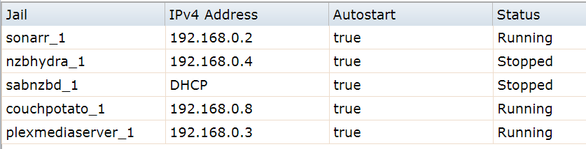

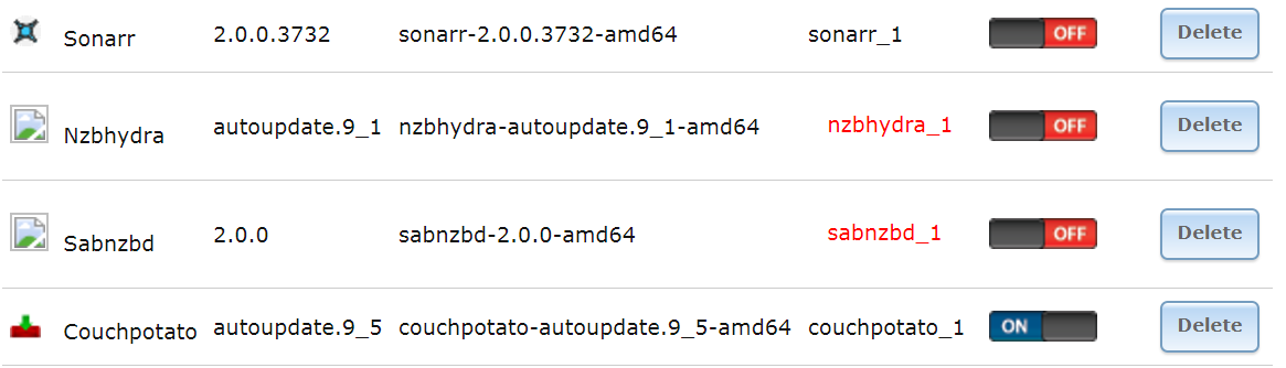

I'm having same issue, only some show as off, some are missing. On 11 stable.
Plex is on and working (doesn't show up at all), Sonarr is on and working. Nzbhydra is off intentionally, so is Sabnzbd.

Side note: Autostart has never worked since 9.3 to 9.10 to 11.0. Disks are encrypted but no jails start after decrypt...
And this is a fresh install as my USB failed last week and I am on new USB with Fresh 11.0 and restored backup file.
