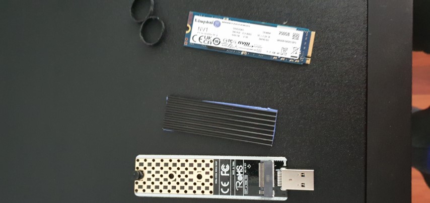

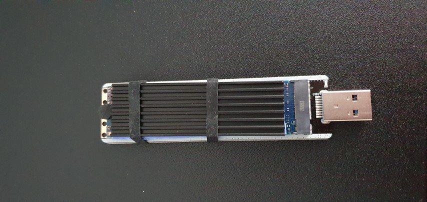

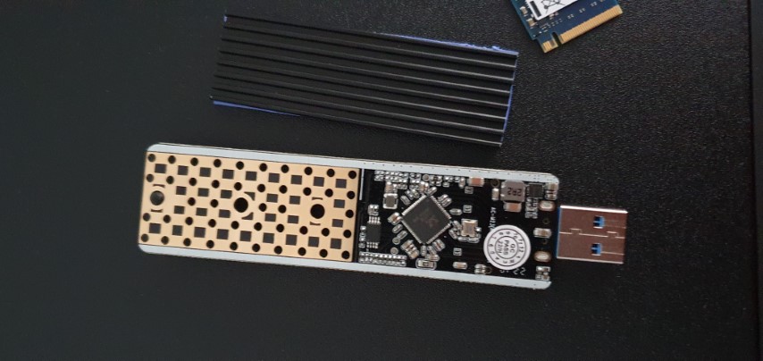

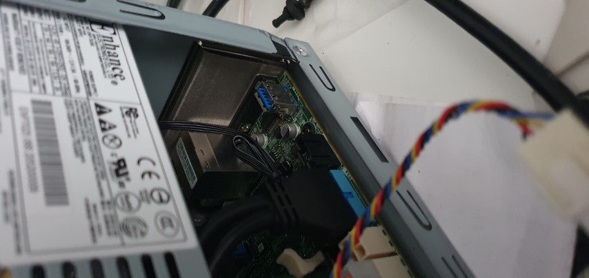

This is good idea, but why not use the adapter, Its boots fine from it without the need of bootloader, and the speed I get on it is about 400MB/s, but I suspect the OS doesn't need any more speed.
