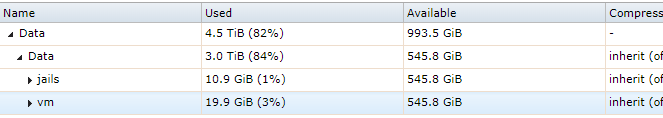

This is the screen grab from the storage summary:

Your data from your screenshot: used 4.5, available .9935.
You got a point here. He got the right amount per formula. I was looking at the below:
I also had a warning that the capacity of my volume "Data" was at 82%.
Utilization was 82% with 3x2TiB in Raidz1 and still 82% with 3x3TiB in raidz1. Something is not sync'ing ...
