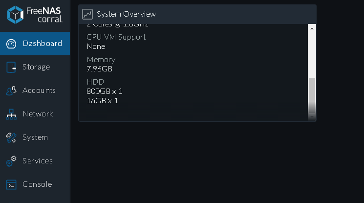

I am running ESXi and Corral as a VM. I initially added the vmdk as 500 GB and then created the pool. Later, I increased the drive size to 800 GB which Corral sees but I do not see how I can increase the pool size in Corral to make use of the additional space.
How is this done in Corral?

Well, using Corral and using a vmdk for storage are two strikes against you. But from the shell, you should be able to do zpool online -e poolname devicename.

Huh? Just delete the current pool and create a new one with the new disk. HDD don't just magically get bigger so this isn't really a normal thing.
You do realize that Corral is dead? If not, you should check the Announcements forum...
