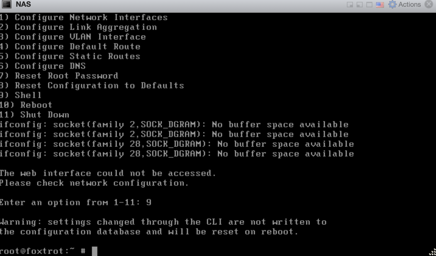

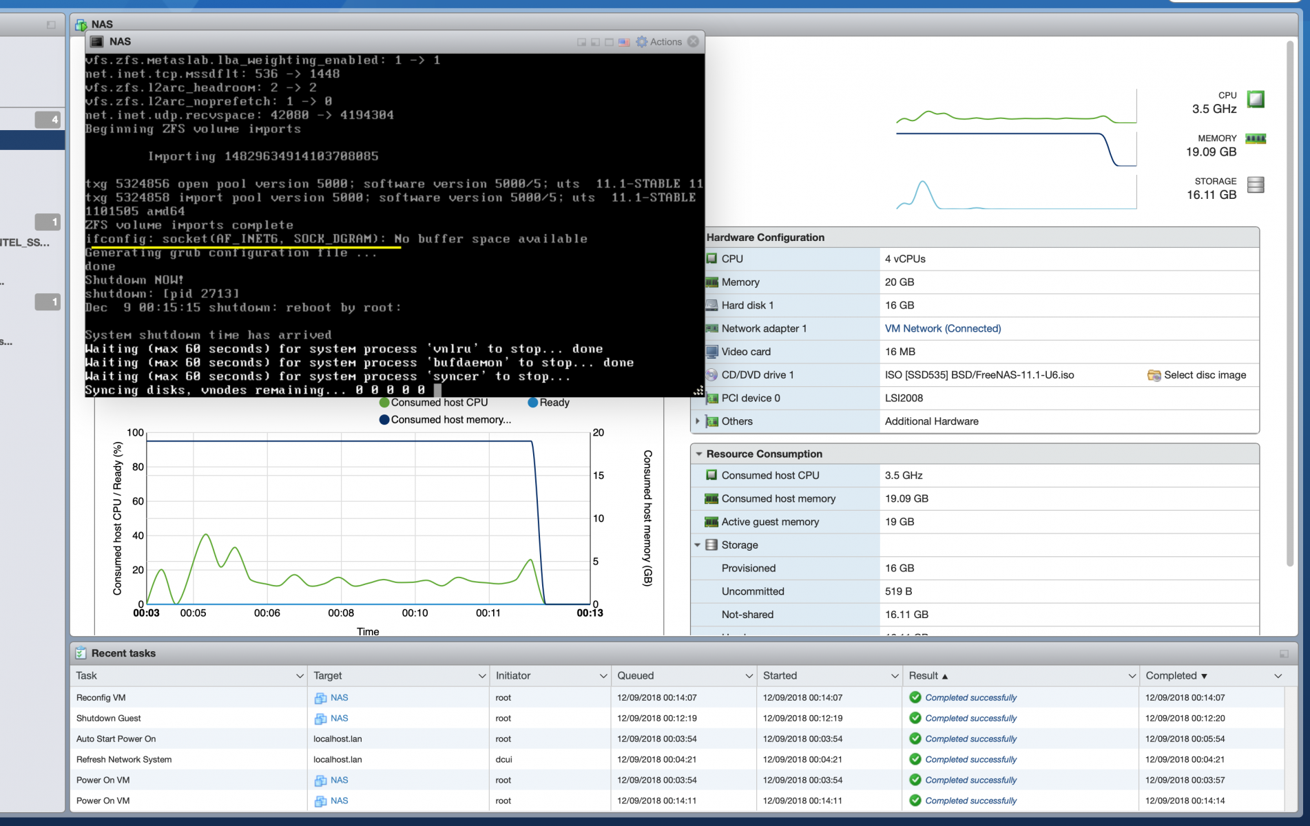

From a cold boot it 1st reboots itself after the zfs volume's imported
on the second boot it keeps spewing ifconfig: socket (family 2, sock_dgram): no buffer space errors. It won't bind itself or jails to preset IPs - so that's no good.

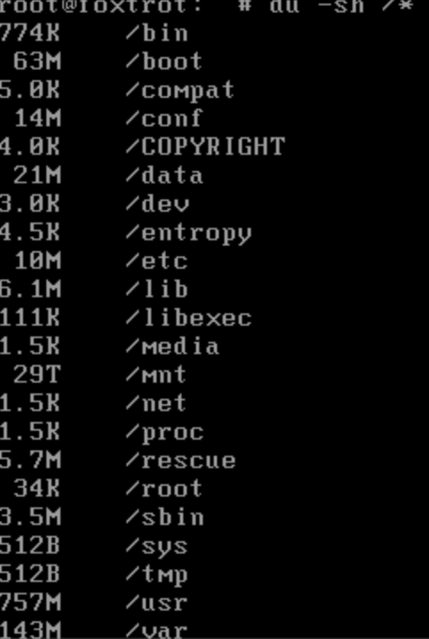

Last thing I did was add a large (500,000+) image library into Plex, which must've generated thumbnails that ate the space. *sigh* I'm now aware there's a swap file that's been turfed out.
However, the boot drive looks fine to me:

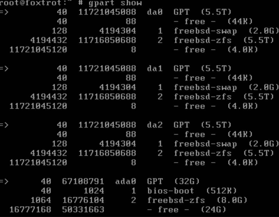

Expanding the boot drive size from 8 to 32gb in ESXI didn't register - I'd need to alter the partition table somehow. Is that the way to approach it?
In here the partition scheme shows ada0p3 as the swap, whereas mine doesn't exist?!
Could you point me in the right direction please?

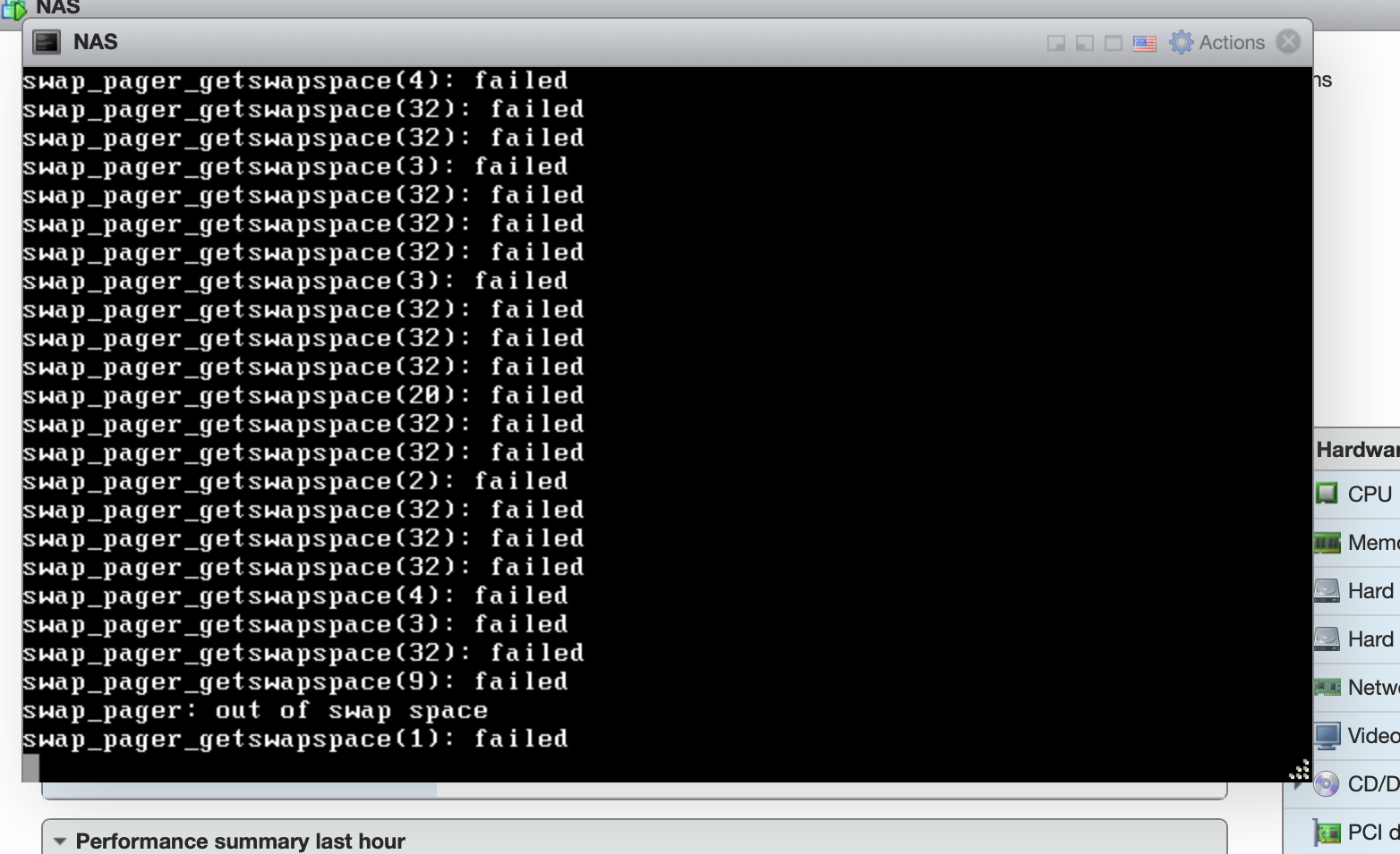

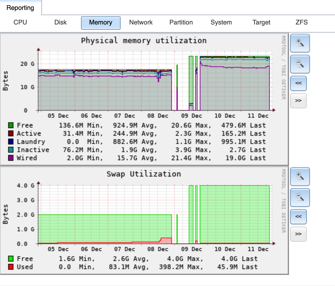

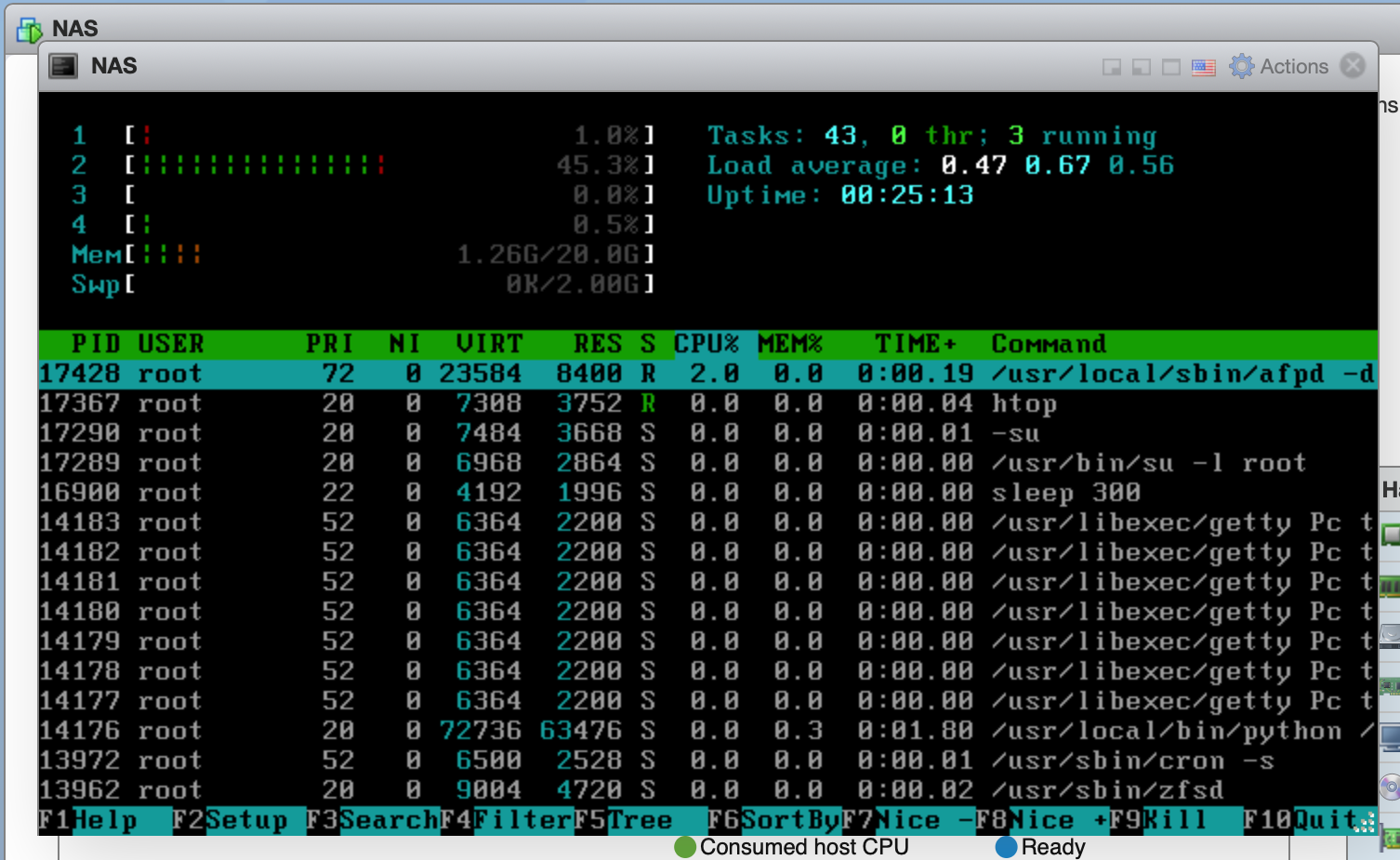

I'm back to step one. Before any of the socket errors, I had swap_pager_getswapspace failed errors that made everything unresponsive. And I had one just earlier:
Swap use is... negligible
Help.
//edit - updated plex from 1.12 to 1.14. Things stabilised for now.
