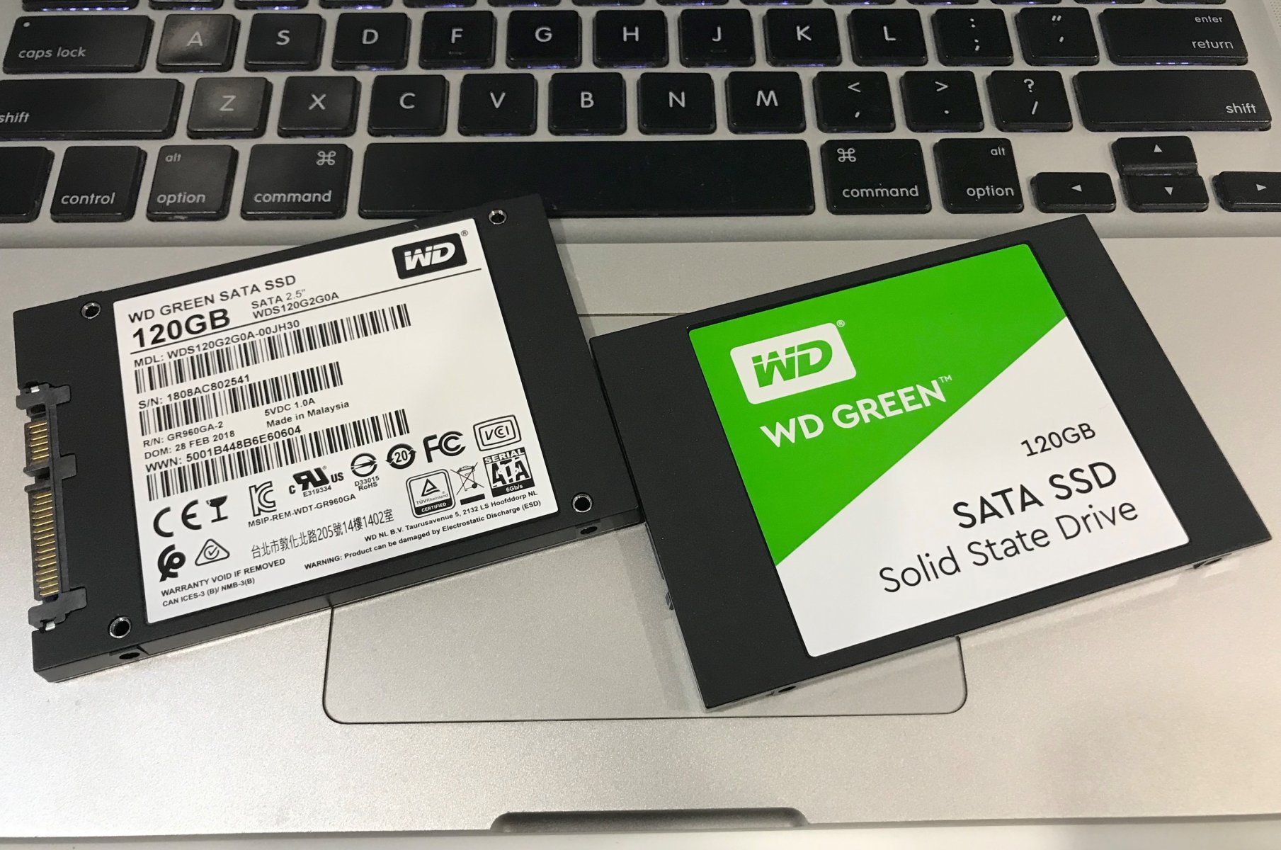

So with WD Green 120GB SSD becoming cheap enough (50 Canadian Rupees each tax incl.), I decided why not, and snatched two of them, hoping to make a mirrored SSD boot.

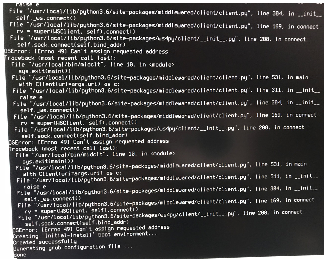

Reinstall time it is then. I was "smart enough" to have made a latest config backup before switching out the first USB drive. So I downloaded the latest 11.1-U5 ISO, dded it into my other USB drive and started installing. It went on fine initially, but after rebooting from the SSD, all kinds of hell were let loose. The log was filled with OSError and things about client.py not happy and etc. When the WebUI was finally up, it asked me for a License Update. WHAT???

So here comes the repeating process. I thought I made a botched USB install drive, so I ran sha256 to make sure the ISO was ok, and then used etcher to make sure things were verified after being transferred to USB drive. Installed again, a little bit of improvement and I was at the web UI, but errors were still being spewed out like crazy in the console. I imported the shiny new config, rebooted, only to find my system crippled. No plugin, no jail, no iSCSI target. Everything seems to require a re-saving to start working. In panic mode, I even rolled my jail dataset back to last night (no real loss), but nothing improved.

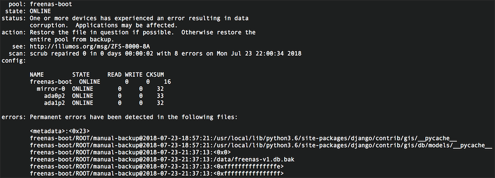

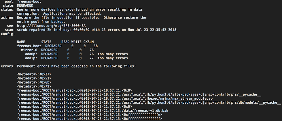

gpart wasn't happy with the partition table inconsistency and spat out a scary "corrupted" status, but it was easily fixed by the recover command. However, just was I was going to create the bigger partition, I noticed the infamous checksum numbers starting to grow symmetrically on the two SSDs. In a few moments, it grew into over a hundred and with the text "too many errors" next to them.
I rebooted the system and nothing seemed to be wrong in the console. I verified the installation and no error was found. However "zpool status -v" showed me some permanent errors in files and metadata. And the list kept growing slowly, around the infamous python 3.6 directory.
