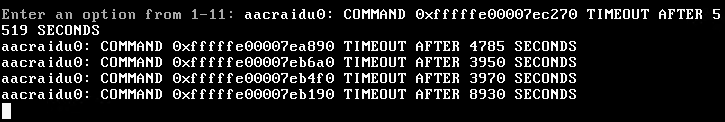

I also see the following in /var/log/messages just prior to the reboot:
aacraid0: COMMAND 0xfffffe00007bdfa0 TIMEOUT AFTER XXXX SECONDS
aacraid0: shutting down controller...done
aacraid0: Enable Raw I/O
aacraid0: Enable 64-bit array
aacraid0: New comm. interface type2 enabled
aacraid0: Power Management enabled
The issue does not occur if there is disk activity. Storage servers with constant, heavy disk activity, are not affected and we see high up-times, eg:

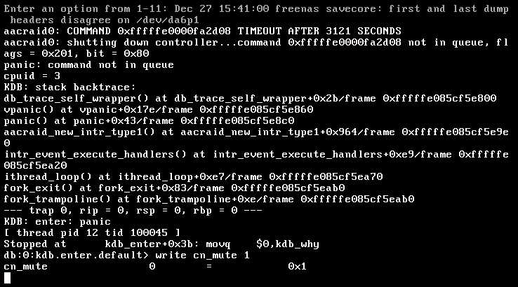

         * Resetting the adapter causes FreeNAS 11.x/12.x to panic with a "command not in queue" error.
         * Let's not reset the adapter and carry on as if nothing happened.
         * This is the command we are leaving out:
         * aac_reset_adapter(sc);
    aacraid_print_queues(sc);
This results in the "command timeout" message being displayed , but no longer causes the system to reboot
Why commands are sitting in the queue for extended periods of time is unclear to me, but they do seem to be eventually cleared out by themselves with no harmful effects.
