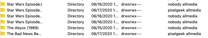

Yes, I stopped the jail, fixed the mount then started jail again. I will restart FreeNAS and do another test.
I am seeing intermittent success with renaming folders/files.
At first, I thought it may be due to mixed owners at the individual folder level under /Movies. But, my latest test renamed the folder even though the owner was pixelgeek.
This successfully renamed and it's owner is "radarr".
This failed to rename and it's owner is "pixelgeek".

thepixelgeek
Jan 21, 2016
271
@Samuel Tai Something is not right. There seems to be an issue when the folder is owned by pixelgeek. See below. That file did not rename either.
Samuel Tai
Apr 24, 2020
5,399
Inside the radarr jail, you'll need to create the pixelgeek account and add it to the allmedia group. The easiest thing is to make sure all the jails have the same set of users/groups.
