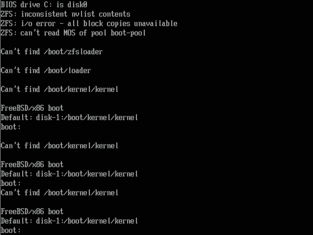

This is a previously working system running TrueNAS core (v13 I think) on bare metal that is no longer booting. I was using a separate storage adapter and RAID array to boot TrueNAS, but I want to free up the PCI slot. So I (naively) placed two new SSD onto the backplane, attached them to boot-pool as a mirror, and detached the array. Of course now it doesn't boot. I've tried performing a rescue install selecting the two new SSD, and also all 3 devices including the array, with the same result (attached). Boot device selected in BIOS is "IDE:#0300 ID1E LUN" which is the only option it gives me under HDD.
Motherboard: Supermicro X8DTN+
Storage: LSI 9211-8i in IT mode with 15x 2TB SAS spinning disks on a backplane, now also with 2x SAS 200GB SSD intended for boot
Boot: LSI 9211-4i in IR mode, 2x consumer grade 120GB SATA drives in RAID1
I think next I'll try removing the new SSDs from the backplane and doing a rescue install just on the original RAID, just to see if I can get it to boot. But, even if that works I'm still going to need help transitioning off it so I thought I'd start my thread and see if anyone has any advice.

It turned out what I needed to do was select the boot drives within the motherboard bios.
It's working now--thanks for the help!
