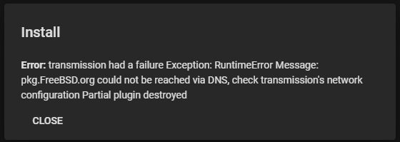

This is TrueNAS-12.0-U3 core, freshly installed on bare metal.
When I try to install the Transmission plugin, it gets around half done and then I get an error:
"Error: transmission had a failure Exception: RuntimeError Message: pkg.FreeBSD.org could not be reached via DNS, check transmission's network configuration Partial plugin destroyed"
Prior to attempting the plugin installation, internet access from TrueNAS seems to be working just fine--I can ping URLs, etc. After I close the error, I can no longer even ping my gateway, though I can ping back to my desktop pc that I'm accessing the web UI from. Everything goes back to normal after rebooting TrueNAS. I attempted this installation 3 times with the same result each time. The Plex plugin installed fine.

Same here
Network setting are well set too. Gateway to my router IP, DNS address as the router dns, without these I won't be able to update Plex.
But I think this one happens from a different issue.
