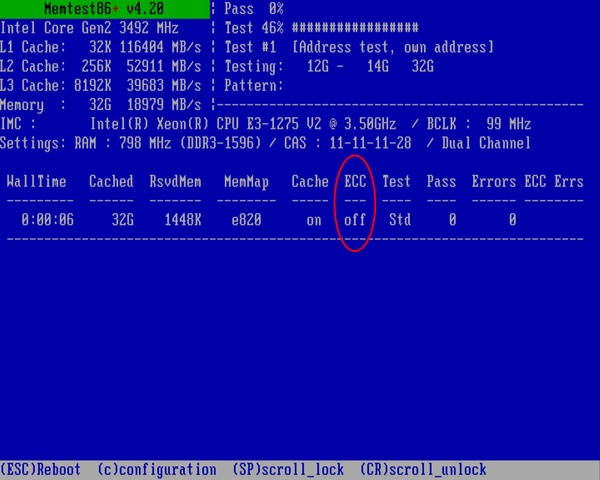

On memtest86, How long??? Also, do I need to do something special in configuration. So far, 20 minutes, no errors but curiously under the column ECC errors there is no notation. Does that come later or do I need to change the configuration setup of Memtest?

Check and see if ECC is showing on or off. If it's off, restart the test after changing the config.

Yep, mine is off. I have tried to enable it several times without luck. I have Googled and found at least one post that says it doesn't mean that ECC is bad but that Memtest isn't detecting it and recommends other ways to check using Ubuntu. I will probably wait for the 4 passes and recheck my bios first.

Don't wait, stop memtest now and see if you can find the"switch" to turn on ECC in the bios/uefi.
Then restart memtest.
Nightowl805
May 12, 2014
77
Bios had it to auto and I switched it to enabled. Also was able to put the correct speed in. Made no difference for Memtest. Still shows off and couldn't enable it. Back to the original plan I guess.
Don't bother trying ecc_check.c. I already have on Haswell-EP and it only outputs garbage.
The only realistic way of knowing that you had an ECC event is to check the IPMI log. IPMI logs RAM errors.

Thanks Eric, I think I will just let Memtest run overnight and then check with Ubuntu in the AM
That's too bad:mad:
Maybe the EPs will be supported in the next version?
