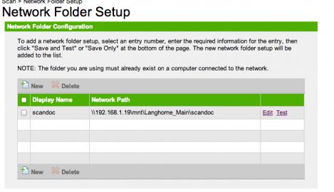

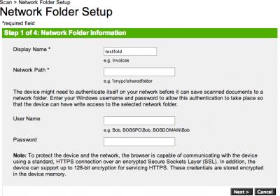

Hey everyone and in advice thanks for you're help. I currently have a Freenas box running AFP with no permissions set everything is set to guest. I would like to map my HP Printer scan folder to the Freenas server. I have tried multiple different ways of setting it up along with trying to setup SMB protocol yet still it will not map. I am including the screenshots of what the HP software is looking for, can someone guide me?

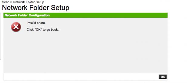

Still no go...
Cyber, yes you nailed it as I was not trying to setup a printer share, just a shared folder to scan to using the Freenas Box. So I have tried and still no dice. Set the SMB to guest and I believe entered the path correctly including the SS, thanks for the continued help.

on your windows computer, browse to the ip of your server using windows explorer, run, whatever
\\192.168.1.19
is there really a folder there called mnt?
based on your screenshot, you are trying to map to the /mnt directory, but unless /mnt is an actual share on your cifs/smb config, you are going to the wrong path

Old post but since I just bought a HP 477FNW Color Laser/scanner I had the same issues. Here is how I got it to work on Nas4free.
1. Make a new user called hpscan with a password and guest access
2. Make a folder called HP SCANS. Use the folder option to make sure its read write for all. (later you can restrict it) you just want to get it working for now.
3. On the NAS set up SMB settings then create a SMB share
4. In a web browser, type in ip of your HP printer/scanner.
ie. 10.0.0.62
The path should be the netbios name/smb share name
Do not use the actual path listed for the NAS server.
Use netbios name.
ie.
DON’T USE /mnt/ZPoolToshiba/HP SCANS
Use this ==>>> \\DELL_NAS\HP Scans
This worked for me, Good Luck!
