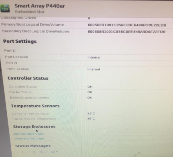

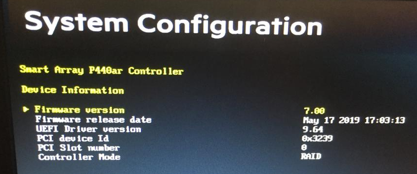

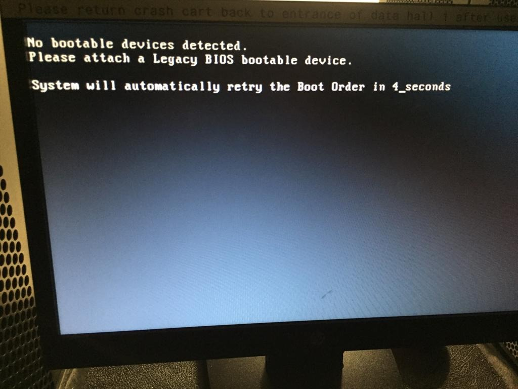

Hey,
The server has the following error:
313-hpe Smart Storage Battery 1 failure - Battery Shutdown Event Code: 0x0400.

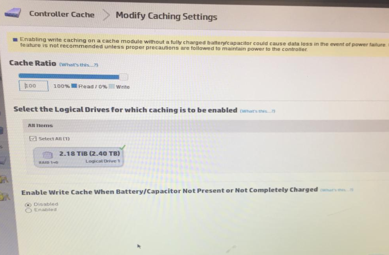

and OS couldn't boot because the cache of the RAID controller was permanently disabled.
Action has been taken:

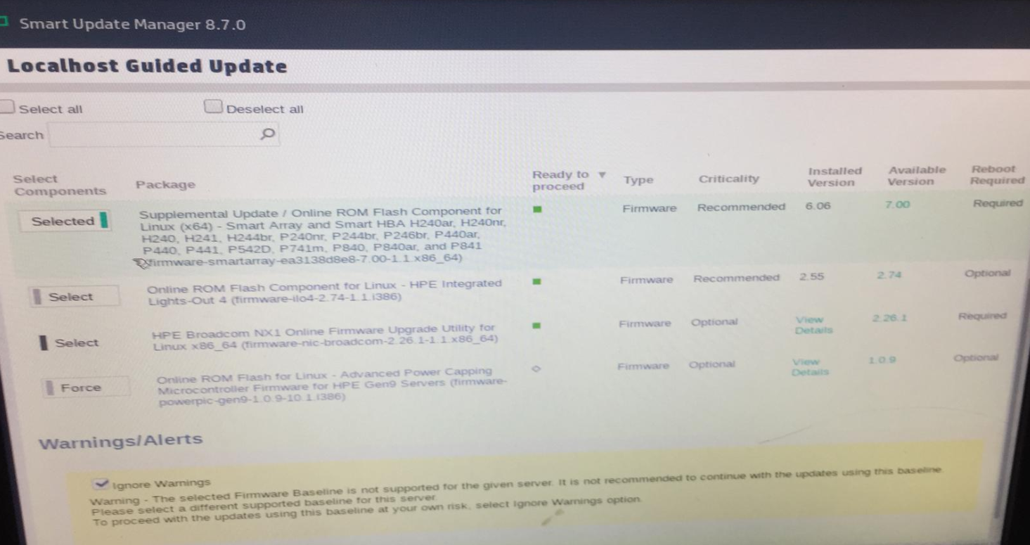

Firmware of RAID controller updated to the latest version 7.00. The batter was replaced.

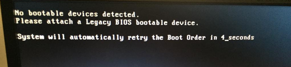

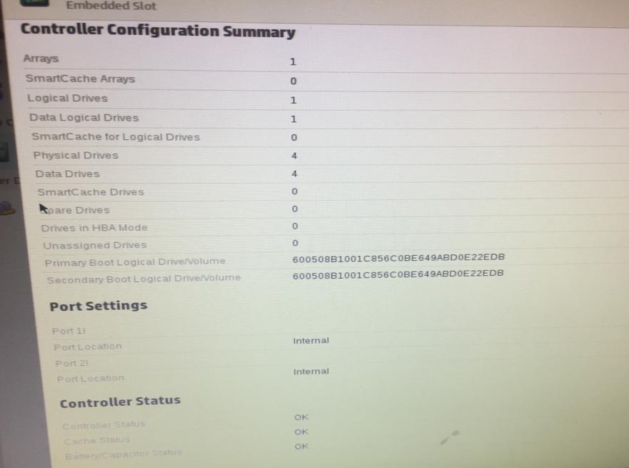

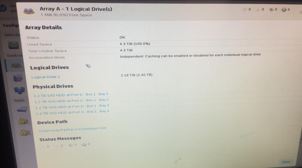

The error of the battery is gone. But still, OS can't boot because it isn't detected any logical drives.

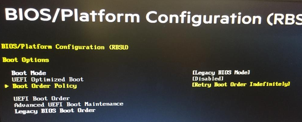

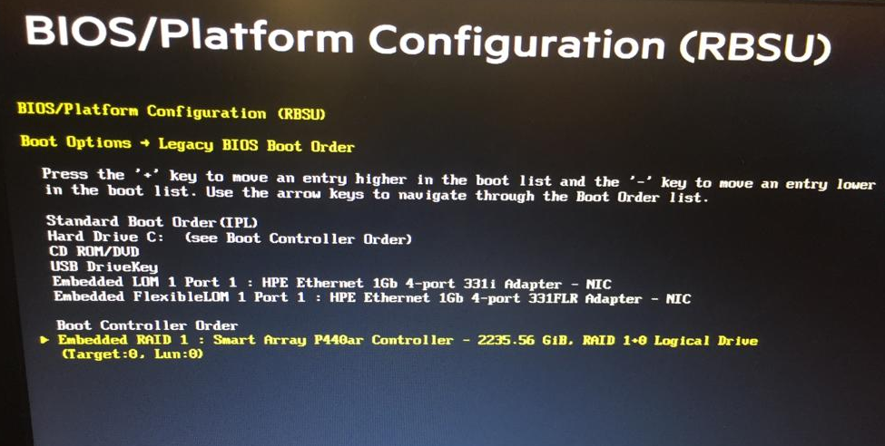

I go to IP -> smart array and the array exists in raid10. I set boot logical volume as the primary.
Boot mode I leave it as it was: Legacy bios mode.
Still didn't help.
Any advice?? What to do?
Thanks in advance
