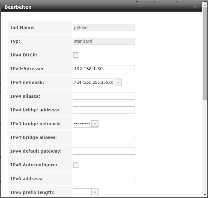

VIMAGE must be disabled.
I dont have set the default gateway. Just disable dhcp and set your IP-Adreass and Subnet mask
have you done:
portsnap fetch extract
in your jail userland?

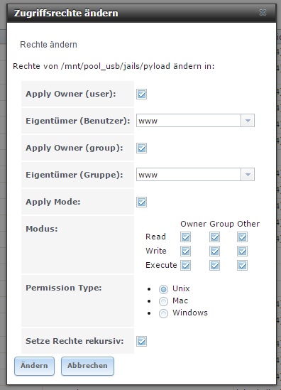

You have the wrong permissions set for your jail. Find the picture attached and set the permissions like shown.
Then try 'pyload' again
Thanks for the help. Now everything is finally working! Just one little thing ( some of you guys will want to punch me for asking this ): where can i find the download folder?
