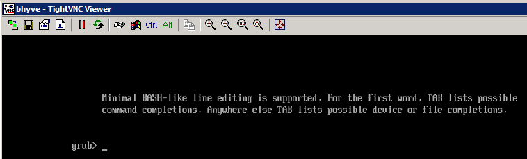

Step 5 immediately drops to grub-shell. I'm not seeing an installer.
The centos7-iso has a grub loader only.
But no worries. I made progress using iohyve. I've got a running centos7 there.
I found the missing lines in https://github.com/pr1ntf/iohyve/wiki/Installing-CentOS-7-on-FreeNAS.
There's a step missing. you first need to set
iohyve set ipa-slave ram=1G cpu=1 os=centos7 loader=grub-bhyve
then launch it, let it load and forcekill it.
both devices.map & grub.cfg are then generated in /iohyve/ipa-slave
Then set it to
os=custom
and continue the procedure.
But maybe I need to generate a proper iso first
https://gist.github.com/vkanevska/fd624f708cde7d7c172a576b10bc6966
Osiris
Aug 15, 2013
148
I am. k. lemme create a new one.
same deal.
edit: SOLVED
The minimal cd I had didn't do it in the VM gui, although I was able to install from it using iohyve !!!
I've succesfully installed the minimal centos7 as a VM from the everything-dvd.
