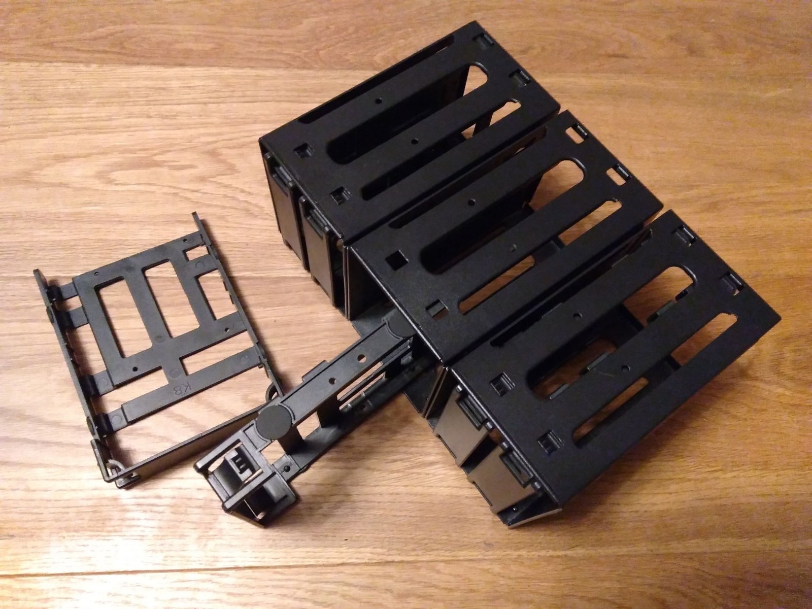

This Nanoxia DS8 Pro looks suspiciously like a slightly cheaper German knock-off the Swedish-designed Define 7. (I have both.) Savings are on the non-reversible plastic front door and thumbscrews which are a bit too small to be comfortable. Side panels are similarly heavy and well-damped. Nanoxia actually ouwits its model by providing the vertical GPU bracket as standard and with its tool-less trays for HDDs and a better model for wiring—no reconfiguring to use for storage and no hassle with screws; rather, you remove the HDD cages if you don't need them. (Make sure to get the Deep Silence 8 Pro: the base model does not come with all HDD cages.)

The Nanoxia Deep Silence 8 Pro does look interesting, especially as the drive trays look like they don't have the "three-corner mount" design of the Define 7, which I'm a bit wary of. @Etorix, were the tool-less trays on the Nanoxia sufficiently solid, i.e. without vibration? Looking at this review, it seems the trays don't have anything like rubber grommets.

Look hard and you'll actually see four thin rubber disks on the sides of the trays. The trays lock safely in place (front tabs) but can wiggle in their cage so they are very effective at decoupling vibrating disks from the case.
