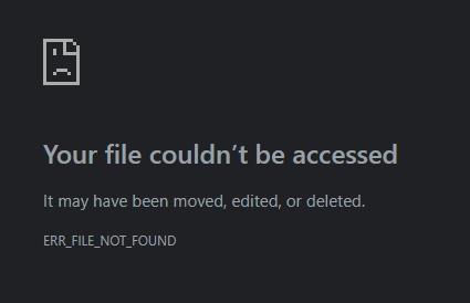

What is the name of the share? Not the "path" or the "server" or the "host". The share name itself.
It's the same name as my dataset that is attached to the pool. So say the name is ShareName.
I tried:
\\my.ip.add.ress\ShareName
Didn't work.
Also, I understand "share name" as what it says under "Name" in the Windows Shares (SMB) menu (underneath where it says Samba).
Turbonium
Nov 22, 2023
19
What is the error message you receive when you try it like this?
Same as without the extra bit at the end of the IP...
Turbonium
Nov 22, 2023
19
Why are you trying to connect to your SMB share through the Google Chrome web browser? :oops:
You know, sometimes I wonder about myself.
I really do.
I really really do.
Honestly though, I could have sworn I had tried it with Explorer earlier, but probably had configured something incorrectly at the time. Then, between fixing the config and now, I somehow "migrated" over to my Web browser, without noticing.

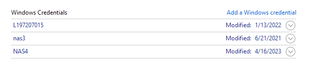

SMB and Permissions settings take care of everything. My relatively vanilla setup works without giving me any issues that I know about.
You have nothing for computers on your network under the Windows Credentials tab?
I have absolutely nothing under Windows Credentials.
"No Windows credentials."
Still, does anyone know if this here (my having no Windows credentials of any kind on my system) is an issue, generally speaking?
Oct 22, 2019
3,641
Not really an issue, no.
It's just used to cache your credentials, so that the next time you try to access the same share, you don't need to enter the username/password.
